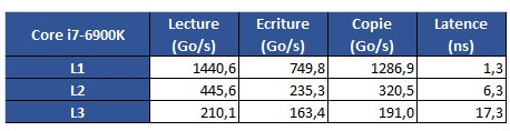

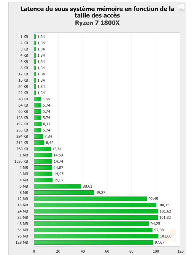

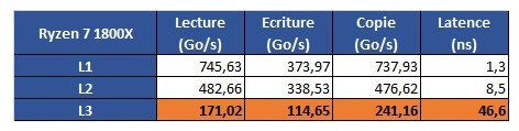

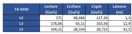

AMD's Ryzen 7 lower than expected performance in some applications seems to stem from a particular problem: memory. Before AMD's Ryzen chips were even out, reports pegged AMD as having confirmed that most of the tweaks and programming for the new architecture had been done in order to improve core performance to its max - at the expense of memory compatibility and performance. Apparently, and until AMD's entire Ryzen line-up is completed with the upcoming Ryzen 5 and Ryzen 3 processors, the company will be hard at work on improving Ryzen's cache handling and memory latency.
Hardware.fr has done a pretty good job in exploring Ryzen's cache and memory subsystem deficiencies through the use of AIDA 64, in what would otherwise be an exceptional processor design. Namely, the fact that there seems to be some problem with Ryzen's L3 cache and memory subsystem implementation. Paired with the same memory configuration and at the same 3 GHz clocks, for instance, Ryzen's memory tests show memory latency results that are up to 30 ns higher (at 90 ns) than the average latency found on Intel's i7 6900K or even AMD's FX 8350 (both at around 60 ns).
Update: The lack of information regarding the test system could have elicited some gray areas in the interpretation of the results. Hardware.fr tests, and below results, were obtained by setting the 8-core chips at 3 GHz, with SMT and HT deactivated. Memory for the Ryzen and Intel platforms was DDR4-2400 with 15-15-15-35 timings, and memory for the AMD FX platform was DDR3-1600 operating at 9-9-9-24 timings. Both memory configurations were set at 4x 4 GB, totaling 16 GB of memory.
From some more testing results, we see that Intel's L1 cache is still leagues ahead from AMD's implementation; that AMD's L2 is overall faster than Intel's, though it does incur on a roughly 2 ns latency penalty; and that AMD's L3 memory is very much behind Intel's in all metrics but L3 cache copies, with latency being almost 3x greater than on Intel's 6900K.
The problem is revealed through an increasing work size. In the case of the 6900K, which has a 32 KB L1 cache, performance is greatest until that workload size. Higher-sized workloads that don't fit on the L1 cache then "spill" towards the 6900K's 256 KB L2 cache; workloads higher than 256 KB and lower than 16 MB are then submitted to the 6900 K's 20 MB L3 cache, with any workloads larger than 16 MB then forcing the processor to access the main system memory, with increasing latency in access times until it reaches the RAM's ~70 ns access times.
However, on AMD's Ryzen 1800X, latency times are a wholly different beast. Everything is fine in the L1 and L2 caches (32 KB and 512 KB, respectively). However, when moving towards the 1800X's 16 MB L3 cache, the behavior is completely different. Up to 4 MB cache utilization, we see an expected increase in latency; however, latency goes through the roof way before the chip's 16 MB of L3 cache is completely filled. This clearly derives from AMD's Ryzen modularity, with each CCX complex (made up of 4 cores and 8 MB L3 cache, besides all the other duplicated logic) being able to access only 8 MB of L3 cache at any point in time.
The difference in access speeds between 4 MB and 8 MB workloads can be explained through AMD's own admission that Ryzen's core design incurs in different access times depending on which parts of the L3 cache are accessed by the CCX. The fact that this memory is "mostly exclusive" - which means that other information may be stored on it that's not of immediate use to the task at hand - can be responsible for some memory accesses on its own. Since the L3 cache is essentially a victim cache, meaning that it is filled with the information that isn't able to fit onto the chips' L1 or L2 cache levels, this would mean that each CCX can only access up to 8 MB of L3 cache if any given workload uses no more than 4 cores from a given CCX. However, even if we were to distribute workload in-between two different cores from each CCX, so as to be able to access the entirety of the 1800X's 16 MB cache... we'd still be somewhat constrained by the inter-CCX bandwidth achieved by AMD's Data Fabric interconnect... 22 GB/s, which is much lower than the L3 cache's 175 GB/s - and even lower than RAM bandwidth. That the Data Fabric interconnect also has to carry data from AMD's IO Hub PCIe lanes also potentially interferes with the (already meagre) available bandwidth
Huh?
69.3 vs 98 is... 3 times?
PS
Are they testing "Core from the left quad accessing L3 of the right quad" scenario? (CCX in the title hints at that, but nothing in the chaotic text of OP talks about it.

Author of the article here, I know the language barrier doesn't make things easy but there are a few innacuracies here in this summary. Some quick points on what we found :
- Memory latency (not L3) is higher (and ns, not ms ;))
- L3 is split in half and communication between the two CCX is thru the same link that links the CCX to the memory controller, PCIe, etc, at a much lower speed.
Plus many other things regarding CCX etc. I don't know how good a job Google Translate does of our article but I'd suggest people interested give it a shot (page 22/23 maybe 24 [we found another issue with game performance that's linked to Windows 10] is what you're looking for).
To answer another question, yes, L3 readings are innacurate in Aida (that's why we show them in orange in the table). We do use another test (a beta benchmark from Aida, too) to check latency at different block sizes, that one is the basis of our analysis.

AMD's Ryzen 7 lower than expected performance in some applications seems to stem from a particular problem: memory latency. Before AMD's Ryzen chips were even out, reports pegged AMD as having confirmed that most of the tweaks and programming for the new architecture had been done in order to improve core performance to its max - at the expense of memory compatibility and performance. Apparently, and until AMD's entire Ryzen line-up is completed with the upcoming Ryzen 5 and Ryzen 3 processors, the company will be hard at work on improving Ryzen's cache handling and memory latency.
Hardware.fr has done a pretty good job in exploring Ryzen's cache and memory subsystem deficiencies through the use of AIDA 64, in what would otherwise be an exceptional processor design. Namely, the fact that there seems to be some problem with Ryzen's L3 implementation, in that it produces latency results that are up to 30 ns higher than the average, at 90 ns, than the L3 latency found on Intel's i7 6900K or even AMD's FX 8350 (both with latency around 60 ns).
From some more testing results, we see that Intel's L1 cache is still leagues ahead from AMD's implementation; that AMD's L2 is overall faster than Intel's, though it does incur on average a roughly 2 ns latency penalty; and that AMD's L3 memory is very much behind Intel's offerings in all metrics but L3 cache copies, with latency being almost 50% greater than on Intel's 6900K.
The problem is revealed through an increasing work size. In the case of the 6900K, which has a 32 KB L1 cache, performance is greatest until that workload size; higher-sized workloads that don't fit on the L1 cache then "spill" towards the 6900K's 256 KB L2 cache; workloads higher than 256 KB and lower than 16 MB are then submitted to the 6900 K's 20 MB L3 cache, with any workloads higher than 16 MB in size then forcing the processor to access the main system memory, with increasing latency in access times until it reaches the RAM's ~70 ns access times.
However, on AMD's Ryzen 1800X, latency times are a wholly different beast. everything is fine in the L1 and L2 caches (32 KB and 512 KB, respectively). However, when moving towards the 1800X's 16 MB L3 cache, the behavior is completely different. Up to 4 MB cache utilization, we see an expected increase in latency; however, latency goes through the roof way before the chip's 16 MB of L3 cache is completely filled. This clearly derives from AMD's Ryzen modularity, with each CCX complex (made up of 4 cores and 8 MB L3 cache, besides all the other duplicated logic) being able to access only 8 MB of L3 cache at any point in time.
The difference in access speeds between 4 MB and 8 MB workloads can be explained through AMD's own admission that Ryzen's core design incurs in different access times depending on which parts of the L3 cache are access by the CCX. Since the L3 cache is essentially a victim cache, meaning that it is filled with the information that isn't able to fit onto the chips' L1 or L2 cache levels, this would mean that each CCX can only access up to 8 MB of L3 cache if any given workload uses no more than 4 cores from a given CCX. However, even if we were to distribute workload in-between two different cores from each CCX, so as to be able to access the entirety of the 1800X's 16 MB cache... we'd still be somewhat constrained by the inter-CCX bandwidth achieved by AMD's Data Fabric interconnect... 22 GB/s, which is much lower than the L3 cache's 175 GB/s - and even lower than RAM bandwidth.
AMD's Zen architecture is surely an interesting beast, and these kinds of results really go to show the amount of work, of give-and-take design that AMD had to go through in order to achieve a cost-effective, scalable, and at the same time performant architecture through its CCX modules. However, this kind of behavior may even go so far as to give us some answers with regards to Ryzen's lower than expected gaming performance, since games are well-known to be sensitive to a processor's cache performance profile.
