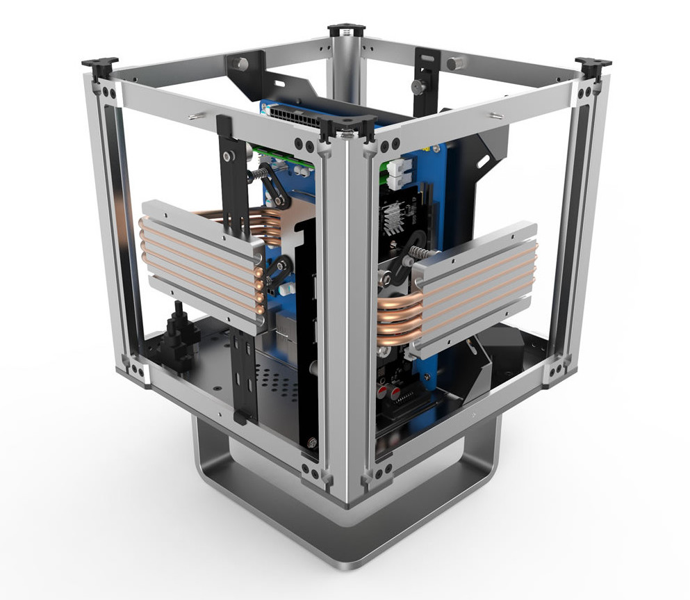

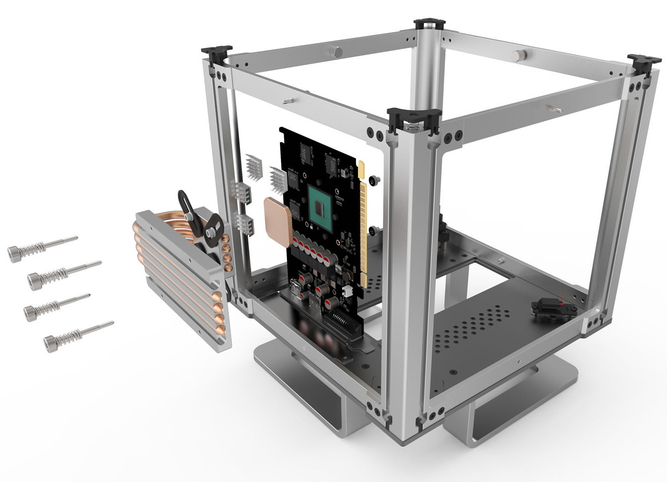

Expert fan-less case maker Streacom is putting final touches to its fan-less GPU heatsink for the DB4 cube-shaped chassis. The cooler transports heat drawn from the GPU onto the main body panels of the DB4, which dissipate it. Its design is similar to the CPU heatsink included with the case, in which a GPU base where four 6 mm-thick copper heat pipes make direct contact with the GPU, transport it onto a second block that makes contact with the innner wall of the body panel. The cooler comes with included heatsinks for memory and VRM of the graphics card, and is designed to handle thermal loads of up to 65-75W, which would mean lower-mainstream graphics cards such as the GeForce GTX 1050 (or below), and the Radeon RX 550 (or below).

why not a sandwich of facing each other Motherboard and video card with a single heat sink or a water block in between.
Because that would be an utter nightmare to mount (requiring screwing in both CPU cooler and GPU cooler from the back of the motherboard and GPU respectively), would lead to a whole host of component clearance issues (tall ram? capacitors on your GPU? Ports on your motherboard?), would make connecting anything to your motherboard after installing the cooler virtually impossible (need to connect a SATA cable? Cool, just remove the cooler from your CPU and GPU, please, and then repaste and reinstall when done), and would force heat from two sources into one heatsink (with all the hassle that brings with it)?
Apple could do this with the trash can Mac Pro due to the custom motherboard. The lack of updates to the platform shows how limited its cooling potential is, though. Not to mention that Apple does not care about serviceability or upgradeability, of course.
