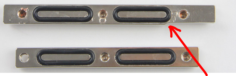

Took me a couple of minutes to get my head around the water flow path caused by the end-of-card inlets.
It seems to cool half of the first VRM bank on the way in, then a quarter of the flow is diverted for all of the other VRM bank before rejoining at the GPU/VRAM coldplate, and then cools the other half of the first VRM bank on the way out?
Given how much machining and effort went into routing out two-layer, multi O-ring channels for the VRMs, I'm really quite surprised that the area of liquid contact of those VRM plates is both tiny and polished smooth. It seems like a waste of all that effort to get LOTS of water at a high-flow/low-impedence past those VRMs and then barely make the effort to do anything with it.
Perhaps this is just a side effect of very limited clearance around those VRMs indeed - I guess the clearance is so ridiculously tight that it mandated this little notch in one of the VRM plates:
Always had my doubts about these tiny VRM "plates". Without much in the way of transfer, they may very well end up being sinks.
You don't need much contact area for VRMs, the actual components are tiny. It's been the same for motherboard VRMs in VRM blocks and monoblocks too. The residence time for the coolant as well as the thickness/conductivity of the materials between the VRMs and the coolant are waaaaaaay more important.
