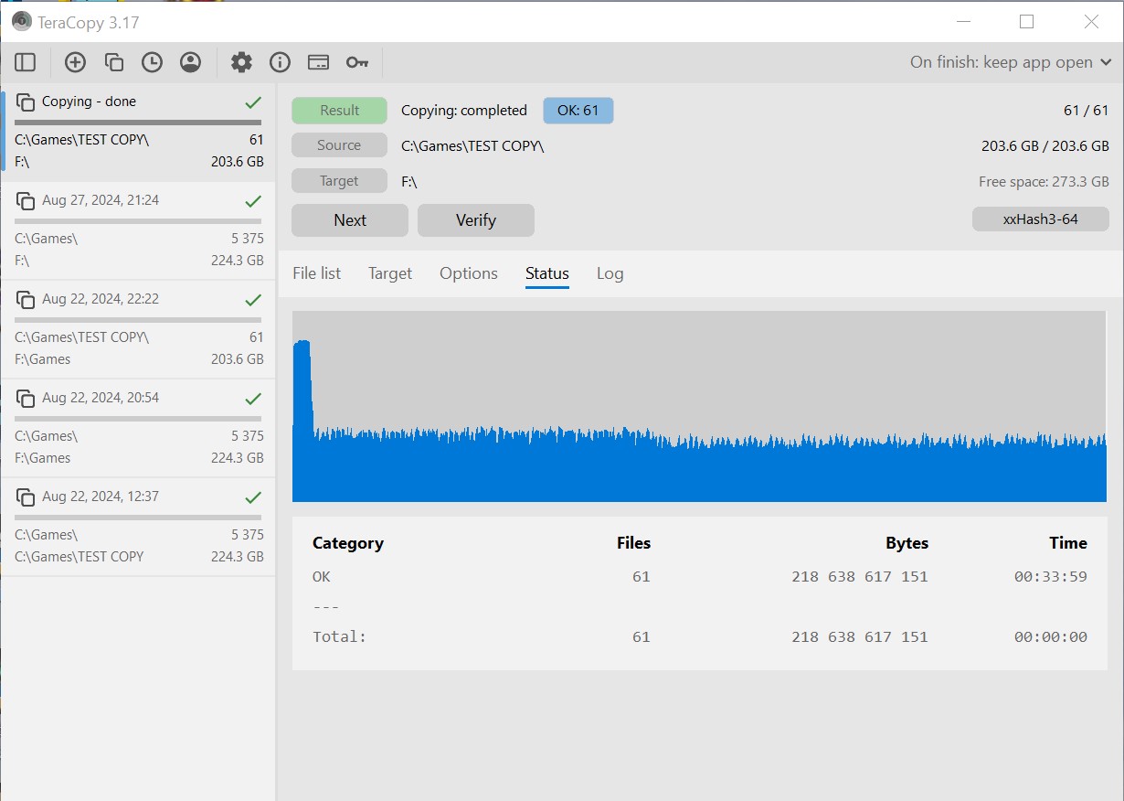

So let's check that via Terry Copy how Long/Slow exactly...
86mb/Sec
Okay... maybe many small files are not a fair comparison? let's check 4gb chunks...
That looks better but is not really any faster... 97mb/s

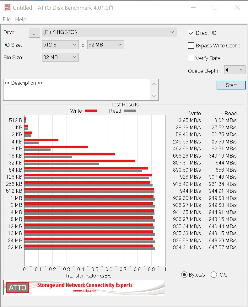

Atto at 32mb File Size does fairly well.. 850-900mb/s write speed.. so my USB Port is not limiting, nor any other Problem with my Computer.
P.S yeah. i used the Port which had the 10GB/s written beside it...
Port Nr 7.
increasing FileSize to 32gb we can see the speed dropping to 550mb/s but still... that woulkd be kinda OK....
