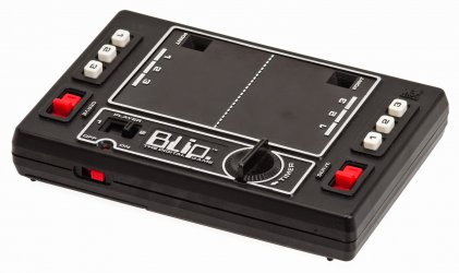

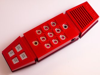

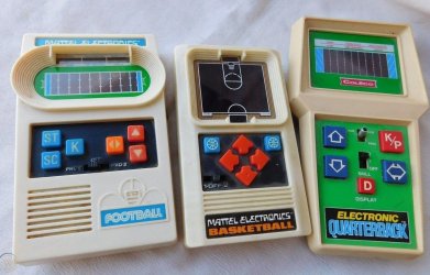

I've been taking these things apart for over 40 years to see how they tick and i've never run into a single issue after reinstall. Other than "creaking" after I've done it too many times. What device had the creaking problem? The original PSP with an ill fitted casing purchased in the aftermarket.
I'm buying mine to use it...not set it on a shelf and stare at it. Make no mistakes here....I'm going to beat the living hell out of this thing and from what I see of the engineering that went into it...it will be able to handle my abuse just fine.

P.S. The Blip. was actually mechanical....the oddest device I've ever owned.
