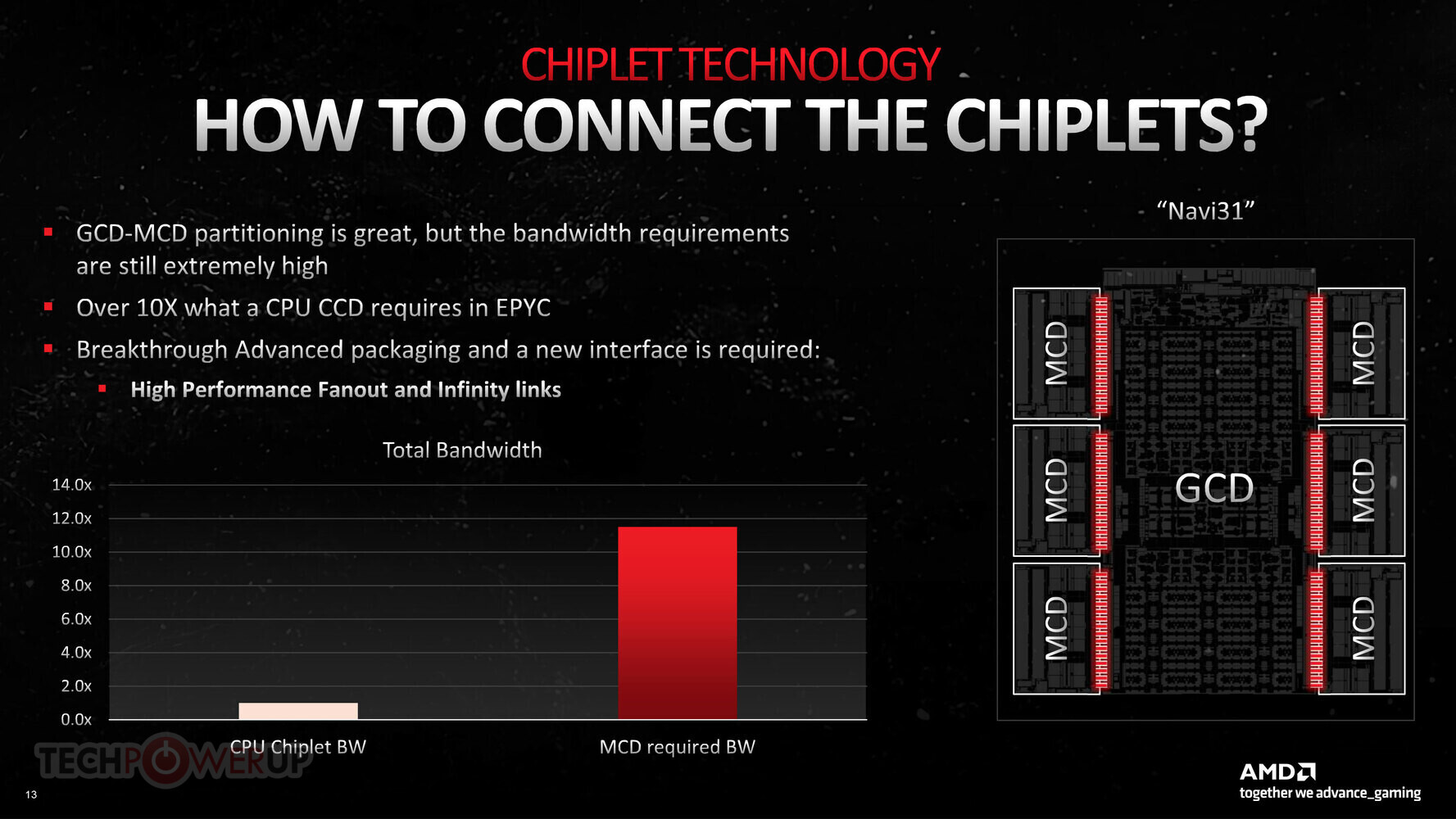

Step one of disintegrating a high-end GPU without hurting its performance, frame-times, and power/thermal characteristics; is to identify the specific components on the silicon that could be spun off into chiplets, that can make do with an older foundry node. For an EPYC server processor, even with 9-12 chiplets, the company only has to deal with hundreds of signal paths traversing the substrate, to interconnect the chiplets. A high-end discrete GPU is a lot more complex, and the scale of these inter-chiplet signal paths number in the thousands (in case of the older "Navi 21" RDNA2 silicon). With the larger "Navi 31" RDNA3, this count is only going to be higher. The company identified the components that made up at least one-third of the die-area that wouldn't benefit tangibly from the switch to 5 nm EUV—these would be the GDDR6 memory controllers, memory PHY, and the Infinity Cache memory (the GPU's L3 cache shared among all Shader Engines).
GPUs with memory interfaces wider than 64-bit tend to use multiple 64-bit memory controllers that are interleaved to create a wider memory interface (such as 128-bit, 256-bit, 384-bit, etc). This is the case with both AMD and NVIDIA. AMD hence decided that not only will the memory controllers be spun off, but also each memory controller with a 64-bit memory path, would be its own chiplet, and have a 16 MB segment of the GPU's 96 MB of Infinity Cache memory. This memory controller + cache chiplet would be called the memory-cache die (MCD); while the rest of the GPU with its hardcore logic components that actually benefit from 5 nm EUV, would be nucleated into a larger centralized die called the graphic compute die (GCD). The "Navi 31" GPU has a 384-bit wide GDDR6 memory interface, and so there are six MCDs. Assuming AMD sticks with the chiplet design for even its smaller GPUs, it can simply use a smaller number of the same MCDs to achieve narrower memory interfaces, such as 256-bit (4x MCDs), 192-bit (3x MCDs), or 128-bit (2x MCDs).

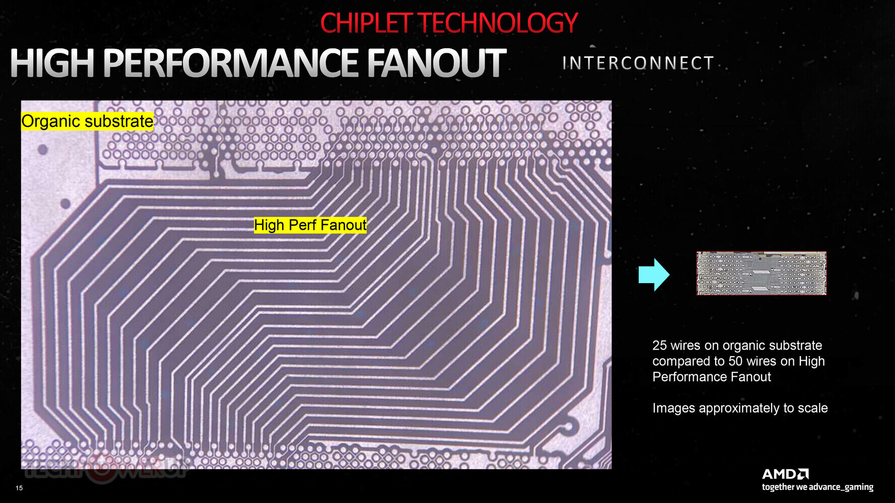

While the interconnect between the GCD and MCDs is still Infinity Fabric, AMD had to develop a new physical-layer wiring technology that used the existing organic fiberglass substrate, to achieve the kind of high wiring densities needed for thousands of signal paths. The company developed the new Infinity Fanout Link physical-layer, which uses a large number of 9.2 Gbps IF links with fanout wiring, to achieve 10x the wiring density between the GCD and an MCD, in comparison to the IFOP physical-layer used to connect a "Zen" processor CCD with the IOD. A fanout is a technique of achieving a large number of equal-length traces between two points, where putting them in straight lines isn't possible. They are hence made to meander along obstacles (such as vias) in a manner that doesn't compromise the equal trace-length needed to maintain signal integrity.
A familiar alternative to AMD for the Infinity Fabric Fanout wiring would have been to use a 3D packaging approach, by using a silicon interposer (a die that facilitates high-density microscopic wiring between dies stacked on top of it). AMD's past MCM GPUs have used interposers to connect the GPU die and HBM stacks. An Interposer is a very expensive way to build a client GPU with headroom for price-cuts in the future, since it's a large 55 nm-class die by itself, which is made to act like a PCB.

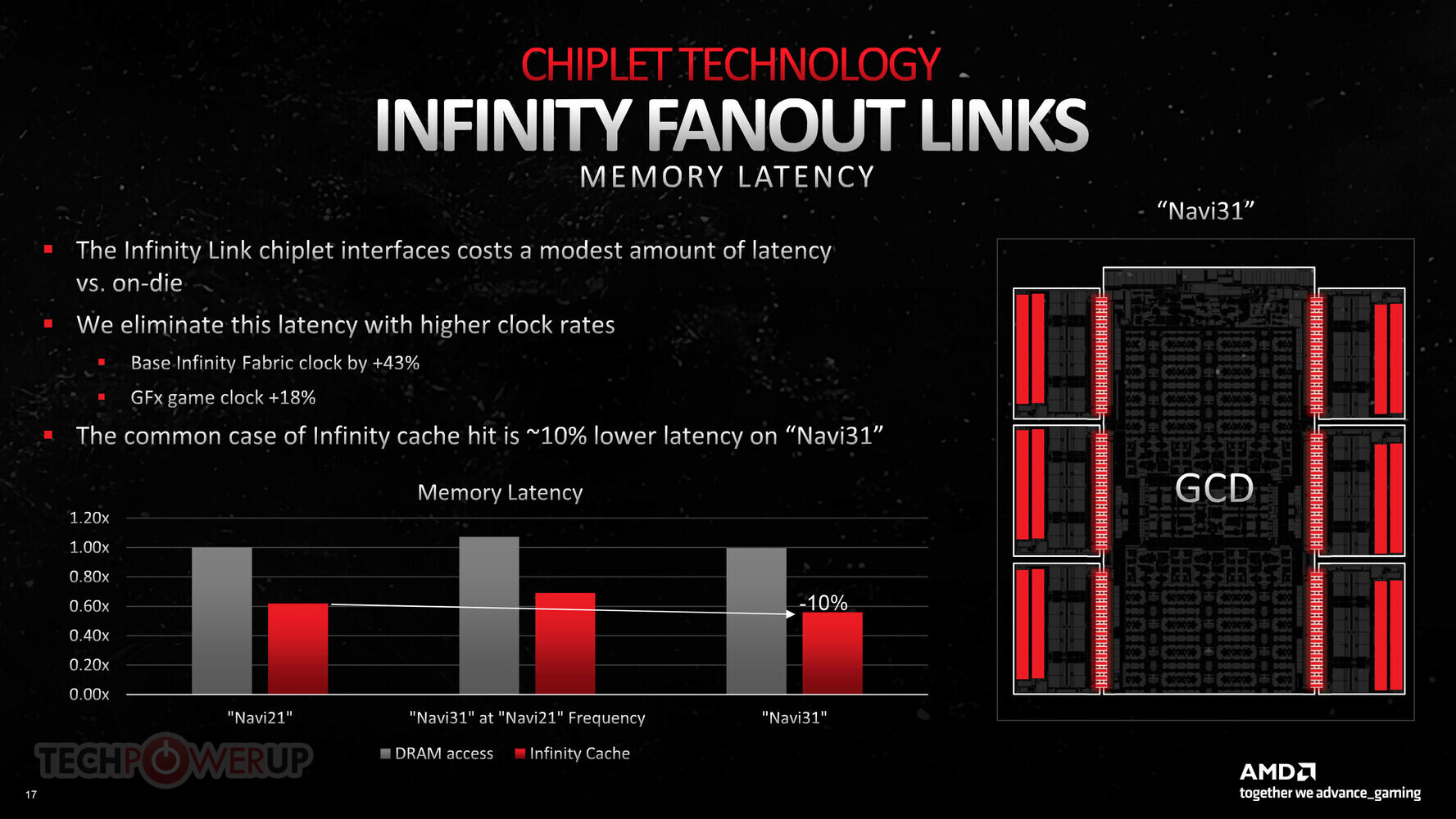

The obvious downside to disintegrating a monolithic logic chip is latency, which is especially critical for a GPU. While the company doesn't specify it, the spinning off the memory controllers to MCDs have added a "modest amount of" latency as opposed to having them on-die (like on "Navi 21"). AMD says it attempted to overcome this latency by increasing the clock-speeds. The base Infinity Fabric clock is 43% higher than that on the "Navi 21," and the game clocks (shader engine clocks) have increased 18% gen-on-gen. The cumulative bandwidth of the Infinity Fanout links between the six MCDs and the GCD, is 5.4 TB/s. This bandwidth is needed, despite the GPU's overall GDDR6 memory bandwidth only being 960 GB/s (at 20 Gbps reference memory speed); because the MCD also contains a segment of the Infinity Cache, which operates at a much higher data-rate than the GDDR6 memory.

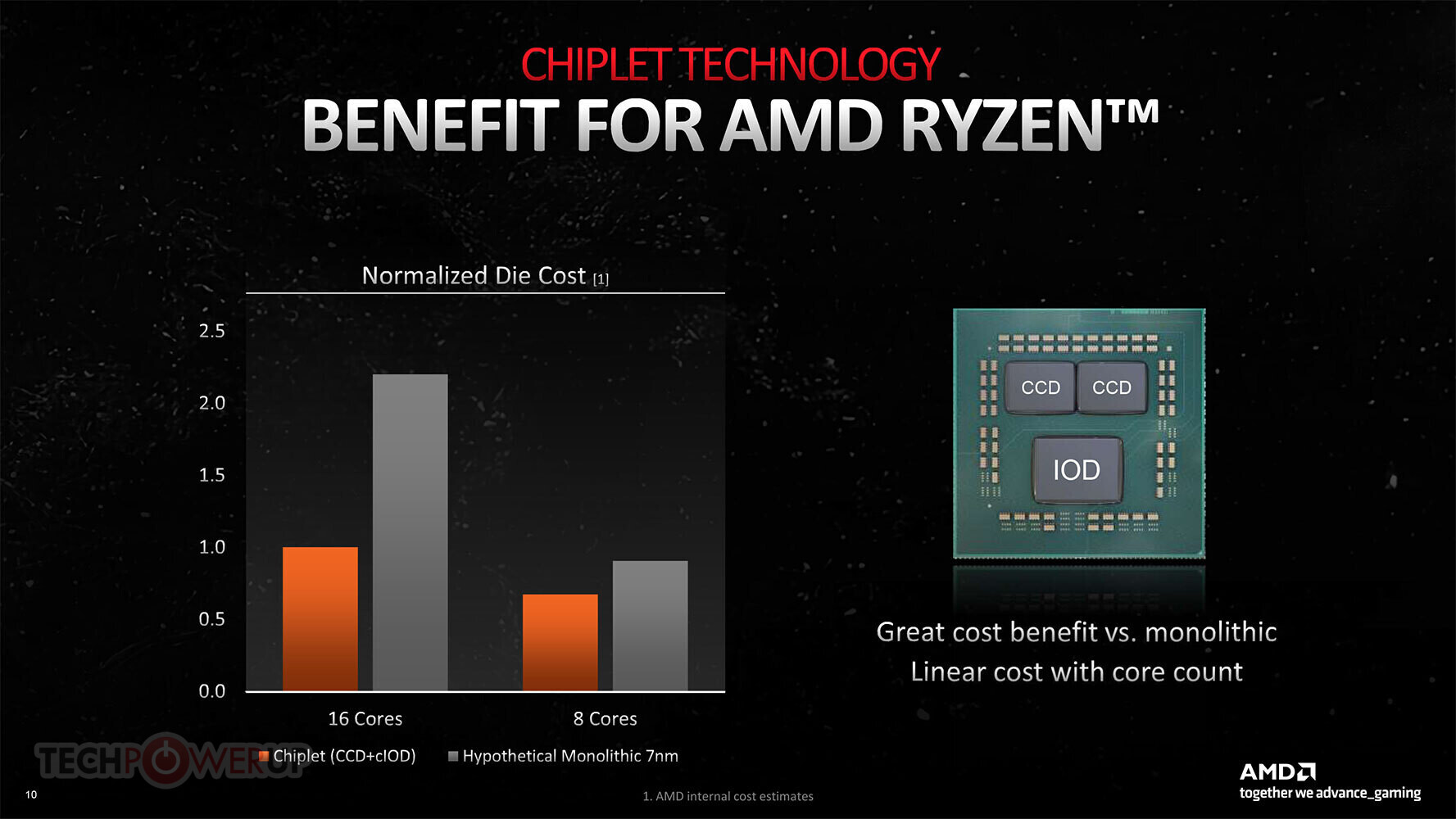

AMD has also, for the first time, explained the economics of the chiplet approach to building its Ryzen client processors. Were a 16-core Ryzen chip, such as the Ryzen 9 5950X, been built on a monolithic 7 nm die, it would have cost AMD 2.1 times more in comparison to its chiplet-based approach of using two 8-core 80 mm² CCDs paired with a cheaper 12 nm I/O die. Because then the company would've had to build a much larger 7 nm chip with all 16 cores on it, the I/O components; and also suffer lower yields due to the resulting die being larger (in comparison to the tiny CCDs).

It's more conventional but still not conventional. It appears to be "2.1D", with a fan-out redistribution layer (RDL), which is some kind of thin and very fine printed circuit made on top of the substrate, below the silicon dice.
The advanced packaging cost is up significantly with AMD’s RDNA 3 N31 and N32 GPUs, but the small fan-out RDL packages are still very cheap relative to wafer and yield costs. Ultimately, AMD’s increased packaging costs are dwarfed by the savings they get from disaggregating memory controllers/infinity cache, utilizing cheaper N6 instead of N5, and higher yields.
The world’s first chiplet GPU, Navi31 makes use of TSMC’s fanout technology (InFo_OS) to lower costs, surrounding a central 48 WGP Graphics Chiplet Die (GCD) with 6 Memory Chiplet Dies (MCD), each containing 16MB of Infinity Cache and the GDDR6 controllers with 64-bit wide PHYs. The organic fanout layer has a 35-micron bump pitch, the densest available in the industry. There is a 3D stacked MCD also being productized (1-hi) using TSMC’s SoIC. While this doubles the Infinity Cache available, the performance benefit is limited given the cost increase. Thus, the main Navi31 SKU will have 96MB of Infinity Cache (0-hi).
