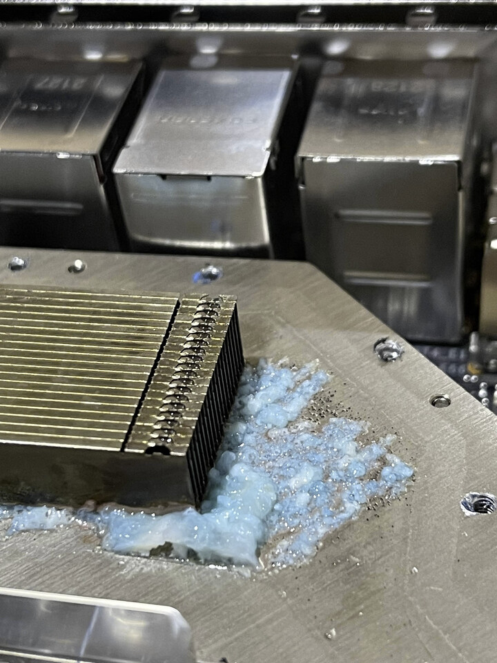

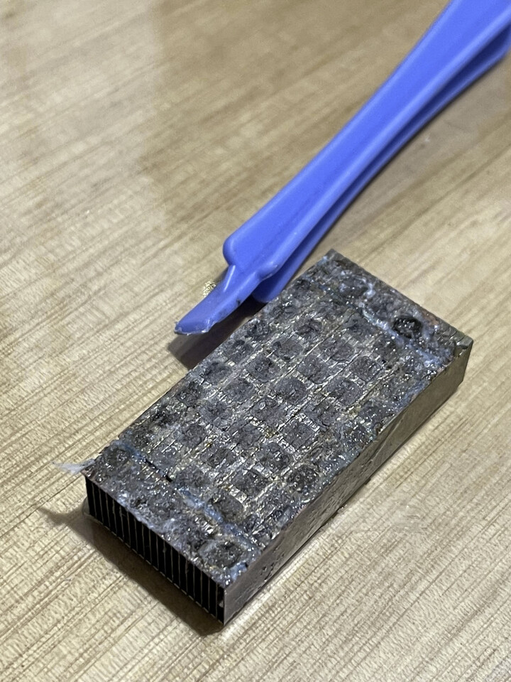

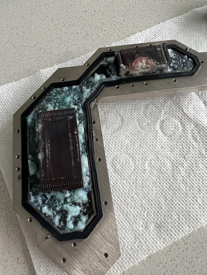

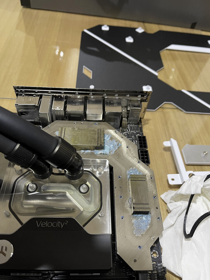

TPU Forum member Trev shared the following photos of his watercooling setup after running just 10 weeks with the VRM block in the loop.

That's flat out incompetence. Mixing metals is wcing 101. Yet these knuckleheads do it with their own blocks. Unfreakingbelievable.
It's not incompetence, it's just plain fraud. I refuse to believe that both Asus, and most of all EK, didn't know about the alloy cold plate and what will happen when You mix it with copper parts. They just skimped and went for a cheaper material, while hiding the fact it may damage all the other PC parts long-term.

Found this great picture from someone complaining about the waterblock:
For those who dare indeed. :D:D:D

You shouldn't mix those two - having problems with nickel plating and purposely mixing alloy and copper in one loop are completely different things.
