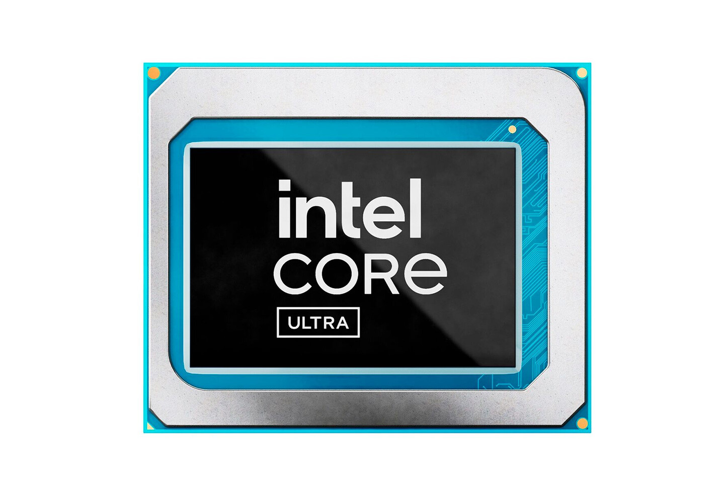

The "i" that was recently sacrificed is exactly the "i" printed on the chip in this picture. As if Intel were embarrassed of their glorious past.
