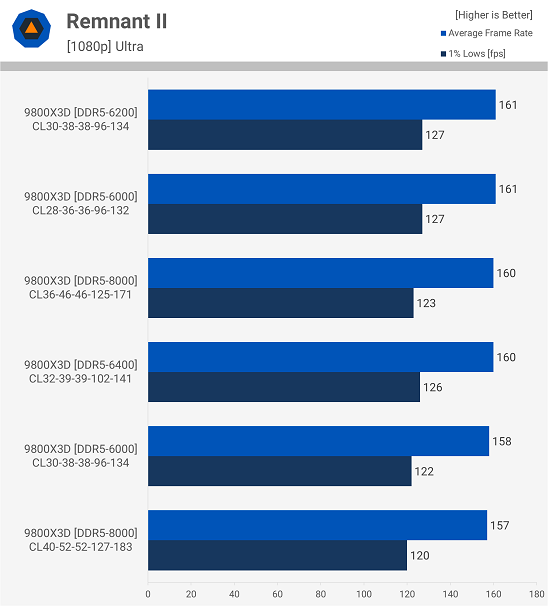

It depends on the game. Some games get good scaling by tuning/oc ram even on 7800x3d/9800x3d:
up to 14% higher avg fps on 9800x3d. Around 2-4% in that test can be attributed to 200MHz higher clpckspeed on 9800x3d.
Everything above 6400 MT/s like shown in the linced YT video is not running with IF 1:1, introduces higher latencies in a lot of situations and you get stability issues on top. Even if the occasional game benefits a couple of frames, most modern game engines do not.

I'm not saying that 8000 is faster than 6400, but ram tuning with lowering rfc and raising refi will be beneficial and in some games give you 10%+ fps. If you can run 8000 stable it will usually be preferable over 6400 due to requiring much lower soc voltage. Similar performance but lower temps.

Yes, the x3D cache runs with low latency as long as there is data in the cache, if there isn't it adds ~7ns (the time it searches the x3D cache as AMD explains) to the operations with missing data, so X+7, which is slower than CPUs without cache.
If you use Aida 64, you'll see that x3D are ~5-7ns slower than non-x3D with the same timings, so yes, as you said, if possible. There are a few games where the game logic is quite small and can fit in the 3d cache and it boosts FPS by very high values.
