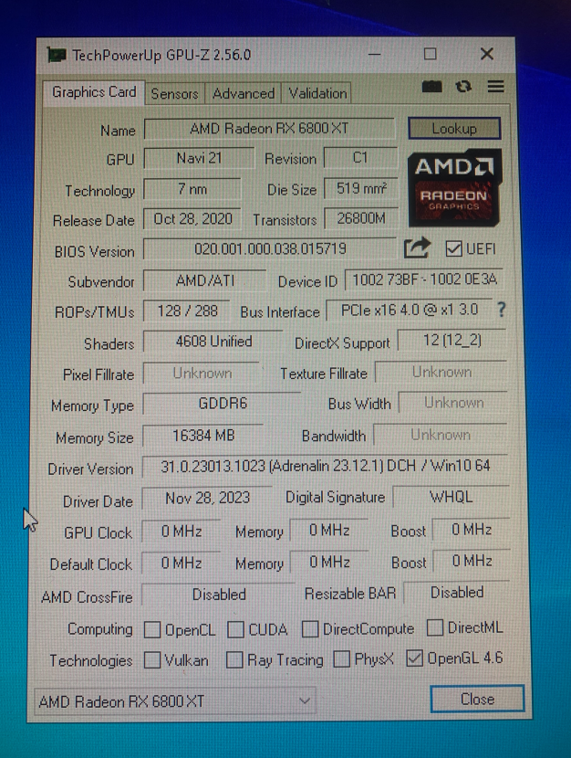

I was attempting to modify settings using Red Bios Editor on my 6800xt. Not sure what happened, but card no longer works. Device Manager recognizes the card is there but disables it. AMD autodetect tool recognizes the GPU and loads Adrenaline, but Adrenaline does not see GPU when Adrenaline is started-up. GPUZ- recognizes the card, but displays 0's where the various settings should be indicated. I've tried to reflash the bios. It goes through the flashing process successfully. However, when I open GPU-Z, it still does not indicate any bios changes have been made.
Pictures are shown below. I'm hoping someone has seen this before, there is a solution, and the GPU isn't bricked. But then again, I may have the proverbial paperweight.

@RD1, the device id in the GPU-Z screenshot suggest you have a reference card.
If you have a reference card, you can use the orginal bios to reflash:
