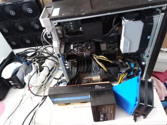

Test rig ready!
No overheating.
I still need windows drivers.
I know not the best idea to put a battery next to a hot video card.

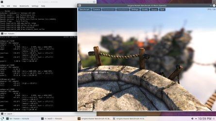

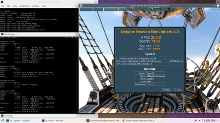

Hopefully, it will be possible now to squeeze some graphics.
Heh, it is.
