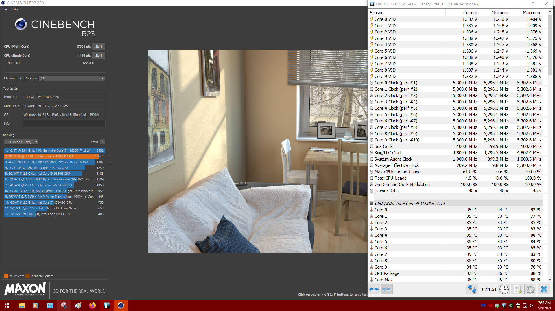

Hi,
Yeah I'm not really liking the mx-5 personally
Haven't pushed my 9940x at all and it's warmer than nt-h1 has ever been which usually tops out at 45c max and mx-5 I'm seeing one core at 49c so not sure it seats very well
I know I had seating issues with 10900k
First R23 run core spread was obviously off at 77-88c

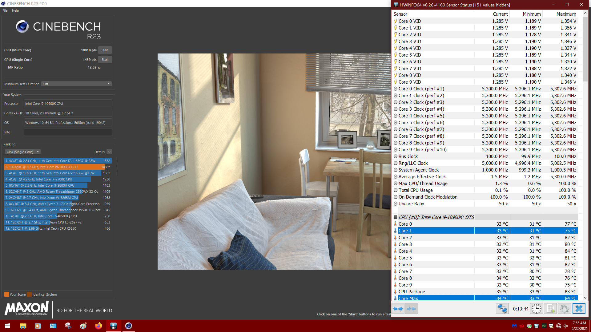

Second run the other morning was better after tightening the block more 75-84c but I did tinker with some bios settings too got a better score too.
Prior R20 run I know was nt-h1 72-80c much cooler so yeah I'll likely switch back to nt-h1 soon I think I lost or tossed my nt-h2 tube can't find it anywhere it was way too wet also.
