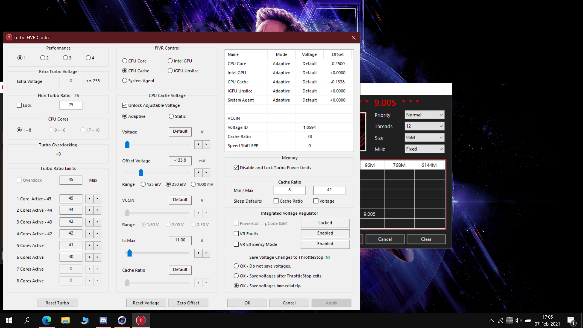

Hey all, found this forum on google as Ive been looking for help diagnosing throttling with my new laptop and figuring out how to resolve the issue IF/WHEN present.
My specs -> i7-9750H Processor with a GTX 1650mobile graphics card.
Any help is GREATLY appreciated. I have throttlestop downloaded with stock settings and the cpuid hardware monitor in case i need to view spec stats.
I also have a laptop cooling pad and a laptop cooling vacuum thingy to help with cooling of the machine.

I have ThrottleStop downloaded with stock settings
There are already lots of posts in the ThrottleStop sub-forum from users with the exact same 9750H. I have explained many times how to test and tune these processors for better performance and better temperatures. I have recommended running the TS Bench and Cinebench R20 and I have posted the download link more times than I can remember. Start by reading through some of the previous advice. Users have shared a lot of information about what voltages and settings have worked well for their 9750H.
Do some reading, do some testing and then post lots of screenshots of how you have ThrottleStop setup. I am here to help you but you need to help yourself a little first.

@Aspire7Rhondy - Have a look at the log file you posted. It shows PL1 throttling at 45W and it shows PL2 throttling at 56W. Acer is enforcing these power limits. There are not adjustments available in ThrottleStop or in any software that will override these power limits. They are controlled internally by the EC.
A well cooled 9750H with unlocked power limits can reach 3200 points in Cinebench R20. Your laptop will struggle to hit 2500 points with the same CPU in the same benchmark.
Your CPU is nowhere near the thermal throttling temperature so changing the PROCHOT Offset value is not going to change anything. Same with IccMax. Neither of these are limiting your performance. The hard locked turbo power limits are killing you and there is no solution for that issue.
If the PROCHOT Offset setting shows the lock icon after booting up, this setting is locked and cannot be changed. Just another strike against your laptop. Thumbs down. :(

At least the undervolt is working. Avoid installing any BIOS updates or you might lose that feature too.
unclewebb
Jun 1, 2008
8,348 (1.35/day)
is it working?
Open the FIVR window and look at the monitoring table in the top right corner. The Offset column shows that your undervolt is working.
When the undervolt does not work, the FIVR monitoring table will show +0.0000 in the Offset column.
Your computer has a locked turbo power limit. No one can fix that.

Your undervolt settings are no longer locked. Good work Acer!
It looks like the core and cache voltages are backwards. The cache should be set to -125 mV and the core to -193 mV. The Intel GPU and iGPU Unslice have to be set equally. I would set both of these to 0.0000. When gaming you are using a Nvidia GPU so undervolting the Intel GPU is not necessary. There is little to be gained and it can cause instability.

I'm still thermal throttling
Why is the thermal throttling temperature set to 87°C? A setting of 97°C is fairly normal for most laptops. Setting this to 87°C is the reason why your CPU is thermal throttling so much. Adjust the PROCHOT Offset value in the Options window to correct this. Your laptop never used to be set this low.

It looks like Acer deliberately made your throttling problems worse. Clear the Lock PROCHOT Offset option and clear the PROCHOT Offset option. Reboot your computer and check to see if the Lock icon is present after booting up. Check if PROCHOT is still set to 87°C on the main screen. I think the Acer tech gave you a kick in the privates and locked the thermal throttling temperature to 87°C now.
changed the thermal module in the laptop
What a con job. Now we know what they really did.
