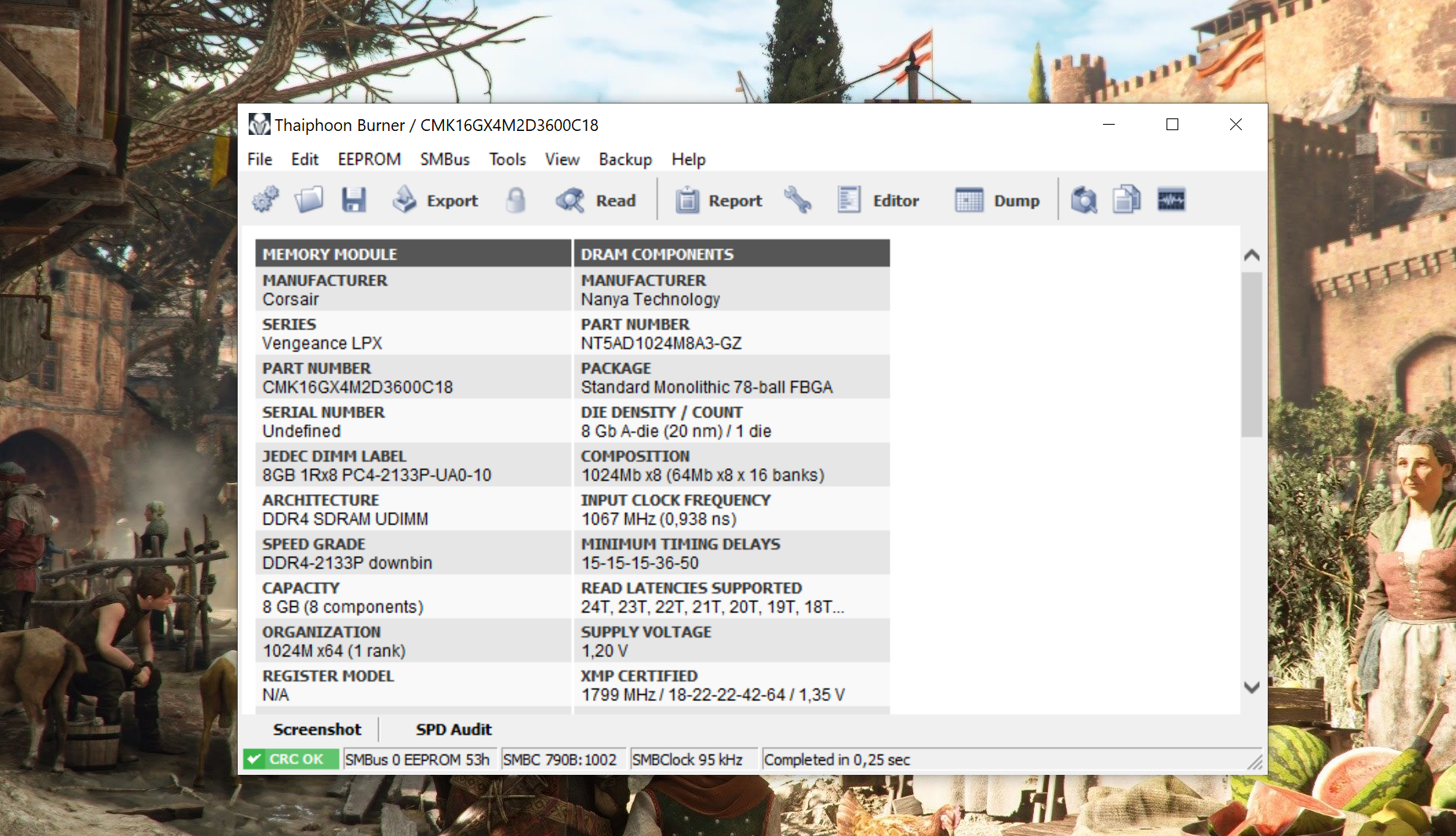

rtx 4080,ryzen 7 5700X,16 go ram 3600 mhz full specs of my ram i don't know if they are good or not i guess good enough if my system is perfectly stable for hours now with everything https://zupimages.net/up/23/10/8jkw.png

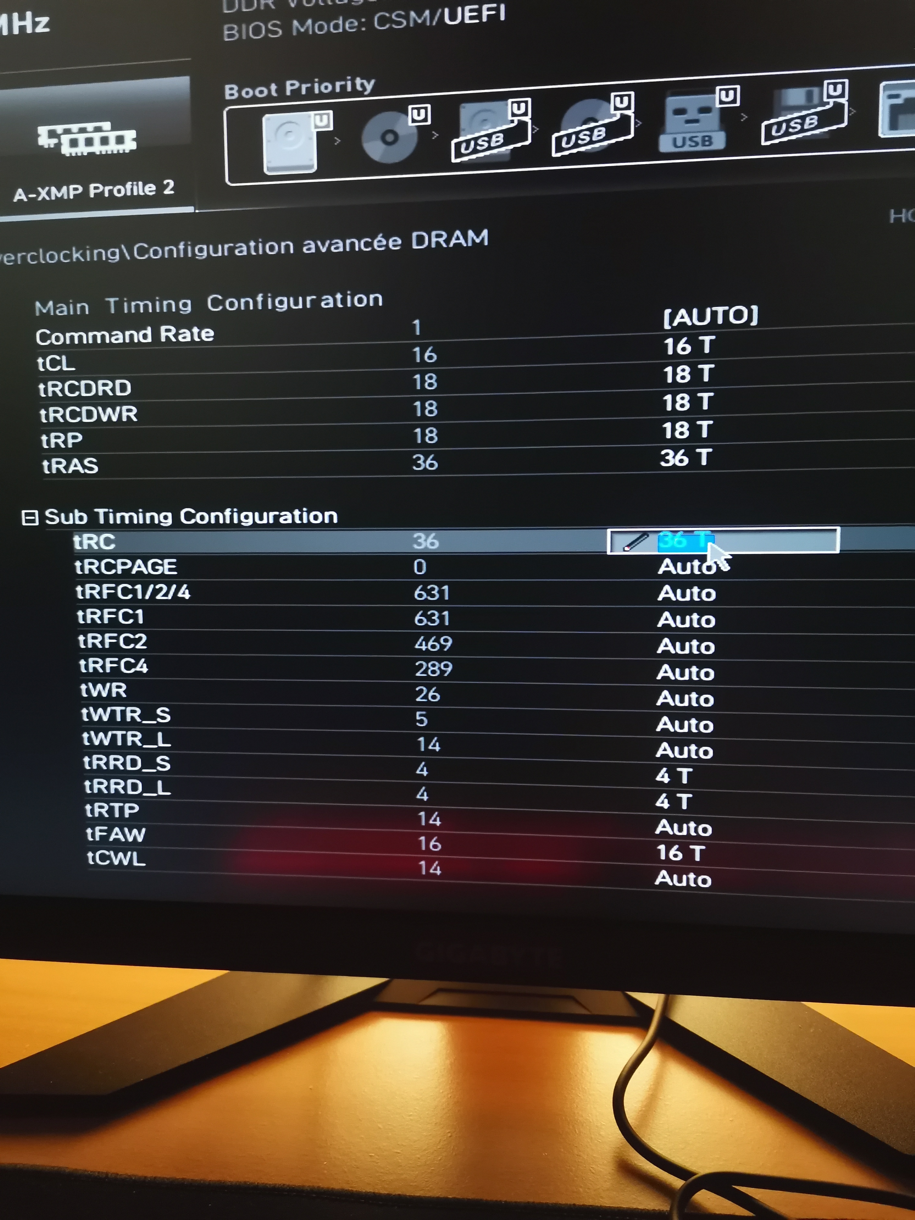

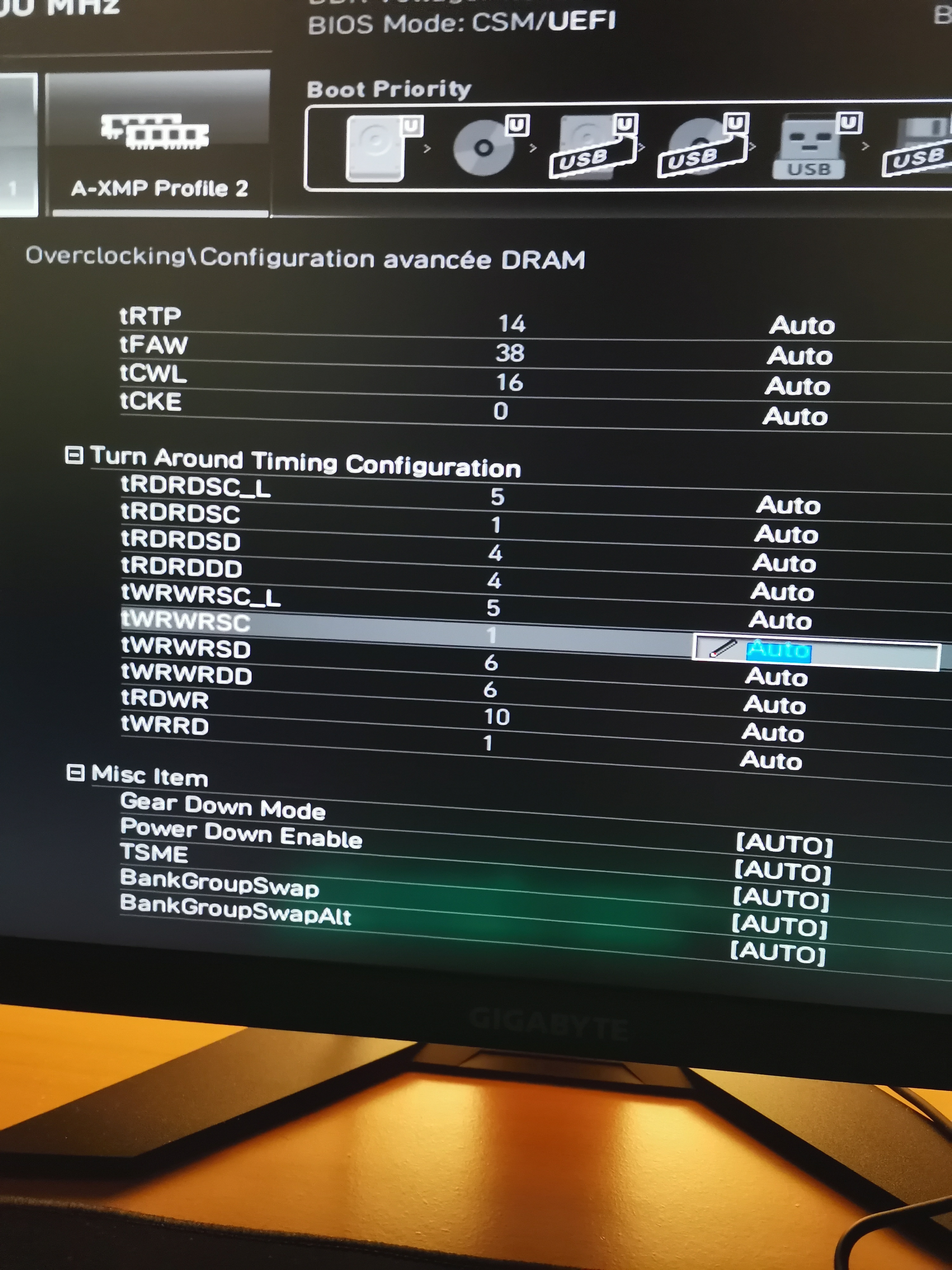

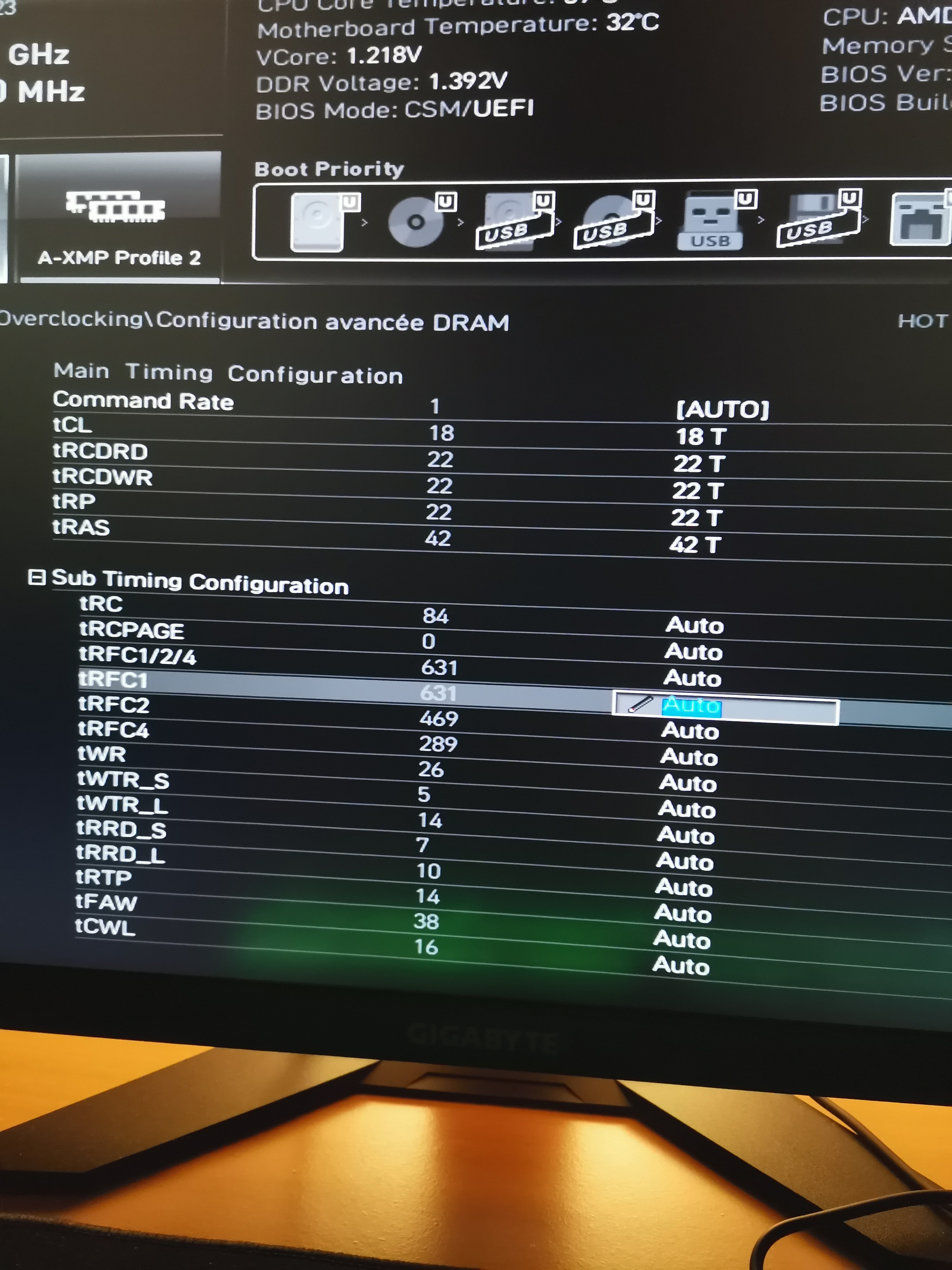

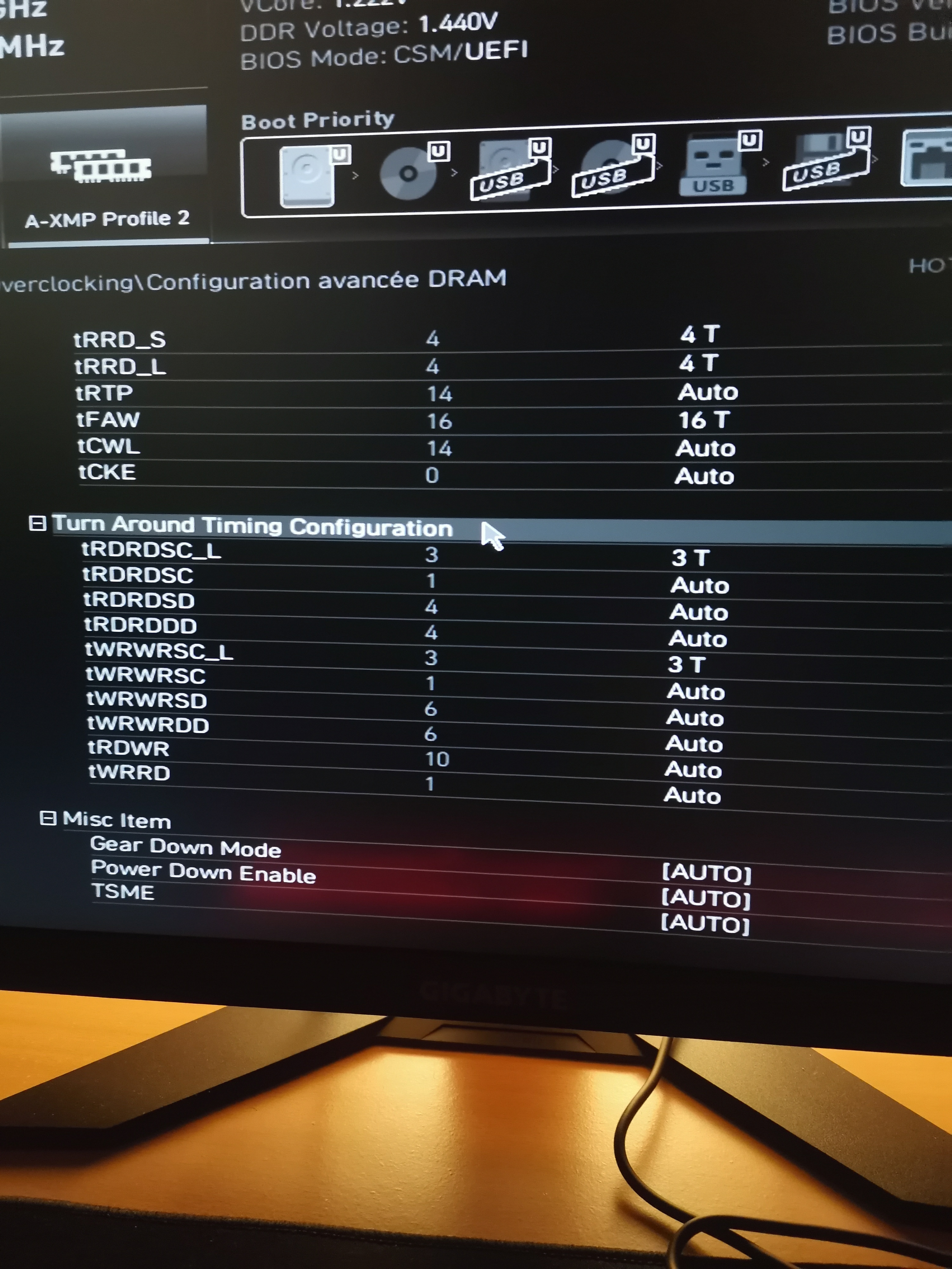

edit: my def timing was 18-22-22-22-64 now it is 16-18-18-18-36 i also modified trc to 36 trrds to 4 trrdl to 4 tfaw to 16 trdrdsc-l to 3 and twrwrsc to 3 this is perfectly stable many hours with prime95 and memtest combined 0 errors i tried again to improve cas latency with 14-16-16-16-34 but memtest failed in 1 min now what would be the best set back to default all secondary and tertiary timings to try c14 or leave it as it is now
original timings :https://zupimages.net/up/23/10/efz3.jpg https://zupimages.net/up/23/10/u7lx.jpg
actual timings: https://zupimages.net/up/23/10/9gpr.jpg https://zupimages.net/up/23/10/z899.jpg
