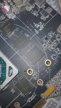

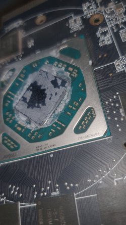

Hello, I have an rx470.
GPU model is 215-0876406
memory model is N5G8032HDC-S-F
I have hardly seen this memory before. I can't find its vbios. I have another graphics card so I'm not afraid of trial and error.Please help me.
N5G8032HDC-S-F
N5G8032HDC-E-F is a Micron compatible clone
N5G8032HDC-S-F could be a Samsung compatible clone.
Can you make a picture of the whole PCB of both sides?
The card seems to be an RX570 instead of a RX470. You need a bios with a C940 in the boot message string.
Samsung K4G80325FB (C940 boot message, 8GB)
Hynix H5GQ8H24MJR (C940 boot message, 8GB)
Micron MT51J256M32HF (C940 boot message, 8GB)
Belated thanks. None of the above BIOS settings made the graphics card work properly. I gave up and gave the card to a friend. Thank you for your kind help.
Please explain “work properly”? Did you get screen but was unable to install the drivers due error 43? The bioses I provided are unverified.
The screen cannot be displayed and the BIOS chip needs to be shorted to start the computer, and the device manager displays code 43.The graphics card is not with me, so I cannot test other BIOS, sorry.
