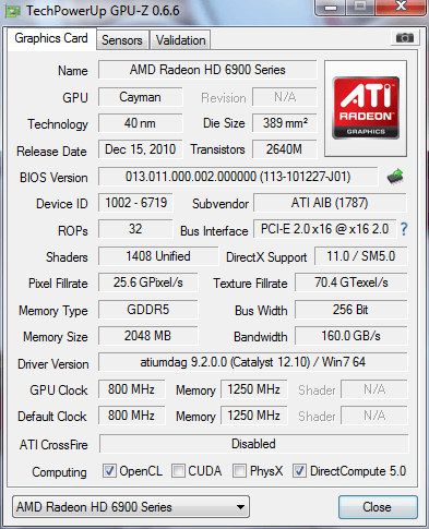

I got my hands on a Club3d 6950 2gb model: CGAX-69548F, that the previous user said : the flash failed and he had a shity mobo with no igp nor other pcieX 16 port avaiable (only x1 port no pci or other kind)
i searched over the forum for solutions it does have a switch for bios but neither bios1 or 2 boot i saved the bios from it to see what went wrong it seems its a 6970 bios (so he tried to unlock it but failed and the backup bios seems to be same)
this is the 1st gpu-Z pics i took at 1st start
and here is the second
between those two pics i tried ATIWinflash (GUI and cmd) with the corresponding bios http://www.techpowerup.com/vgabios/94271/Club3D.HD6950.2048.101227_1.html
but seems that went also wrong...
also Winflash under GUI give me the SystemID error, so mainly why i tried cmd with parameter:
"atiwinflash -unlockrom 1" the card is on the 2nd pcieX 16 and i use a GeForce 405 in slot 1
"atiwinflash -f -p 1 bios.rom"
nothing worked it seems, i saw a status bar for a few second then nothing.

From the GPU-Z screens it looks like the divice ID and sub system ID are intact ; this is good
as you mentioned in the OP try flashing from a dos prompt

Edit: Subvendor 1787 = ATI AIB aka Club3D Sapphire Powercolor and some other
Also i noticed Device ID is 1002-6719 its a ID from 6950, 1002-6718 is 6970 right ...
stupid me ... i mixed the 2 ID ...

funny i can start with the card now but ... :banghead:
currently uninstalling driver and reinstalling them i suspect this will do the trick
WOOHOO before i rebooted Gpu-Z showed 704 shader and i was scared xD then i rebooted and
VOILA!!!
big thanks Law-II i didnt know win98boot could be used like that im not bad when it come to computer hard and software but you helped me BIG time!
