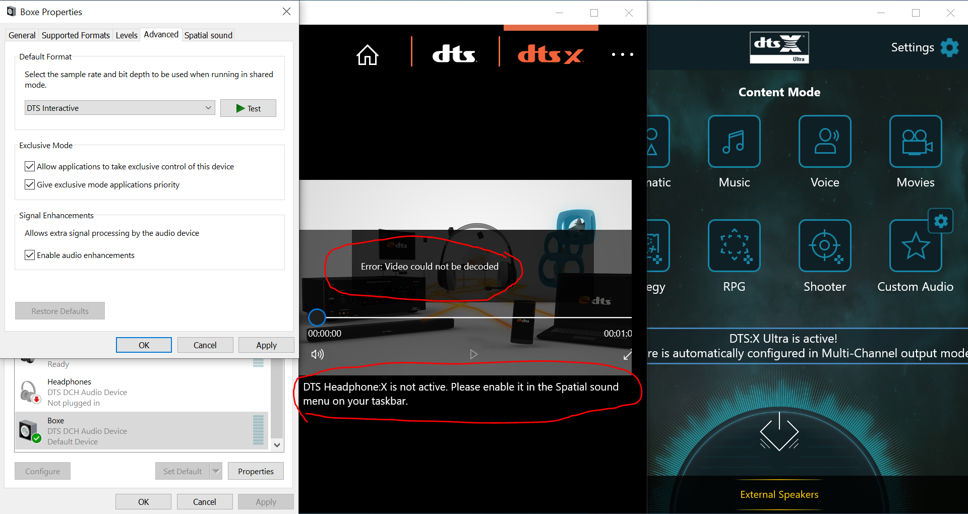

Hi there. I was encouraged to install their audio drivers. I have the Realtek high definition audio installed. Yesterday I have been going through the whole thread. I would like you to help me install what would best fit my laptop, so I can enjoy this experience. I have the backup, it only remains to test. Thanks for your time.
Dec 8, 2020
3,062 (2.01/day)
United Kingdom
Google Translate - Google Translate | No estoy seguro de poder explicarlo de manera diferente, ya que no sugiero aplicaciones de terceros para eliminar controladores.
Una vez que haya eliminado el controlador Realtek, puede hacer doble clic en 'instalar' en el paquete DTS DCH que descargó.
La parte molesta y que consume mucho tiempo es eliminar los controladores no deseados y CCleaner.
Does this help?

Love your work. I've just updated to the latest version 6.0.9159.2.
I do have a question. Is this how is intended to work (like in the attached picture)?
My setup is an MSI B550I (ALC1200) and a Logitech z906, which are connected via an optical cable. In the audio jack, I have a Sennheiser SRS ready headphone.
If I select the output via the headphones DTS unbound shows active. Via S/PDIF, shows that message.
I'm asking to know if I need to troubleshoot anything because I do not remember seeing this on version 6.0.9155.2
Thank you!
