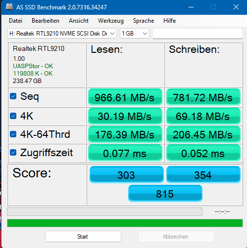

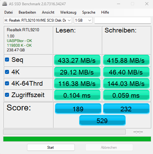

With the RTL9210B controller your only going to get a max of 1 G/Bs read and writes.
Here i tested my version which uses the RTL 9210B chip with this SSD
10Gb usb c
and usb 5Gb
