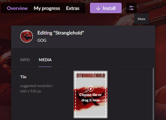

So those 2 games you didn't buy from GOG, but added them manually. Right? :) If so no wonder it didn't work. The fix is only for games purchased from GOG.
Non GOG games you have to fix manually. Just click on the game, click on Settings/More, Edit.., MEDIA & select the image you like to replace (required sizes see below).
If it's not clickable you have to replace the image in the C:\ProgramData\GOG.com\Galaxy\webcache\1234Numbers1234\gog folder manually, like recommended in this post at the GOG forums. For STEAM games just look up the game on SteamDB. Then look for a folder in the GOG webcache folder with the same number as the "App ID" from the game on SteamDB. Then just grab the images from SteamDB ("clienticon" = Icon, "hero_capsule" = cover, "library_her" = background).
You'll need to resize/crop the images & then rename them to ".webp" or convert them to webp. ;) Cover = 342x482pix, Icon = 112x112pix, Background = 1600x650pix.
For games from EPIC Games it would be the same procedure. For EPIC games you'll have to visit ScreamDB and search for the app ID of your game. Of course only if you can't replace the images "the easy way" in the GOG launcher settings.
