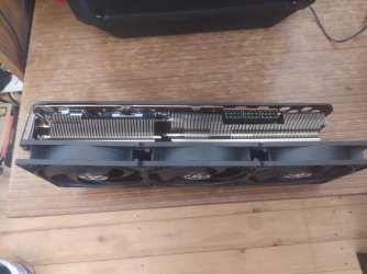

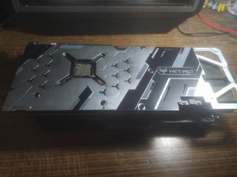

All you need is a flat surface heat sink GPU (or make one with a grinder), zip ties, 2 or 3 high pressure 120mm PWM fans with a decent RPM, mini 4-pin to 4-pin fan adapter (can vary depending on the GPU model, can be found on Aliexpress, Amazon, eBay, or you can make one yourself), a lot of patience and OFC, some skill and courage.
I'll start with my Sapphire 5700XT Nitro+, even though it was a second project (done today), but I forgot to take photos of my ASRock 6900XT OC Formula, and I'm kinda lazy to take it out of my main PC (I'm writing this on) for a photo session. Will do it tomorrow.

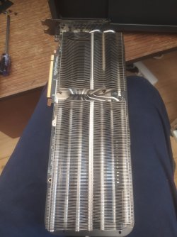

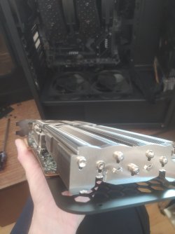

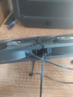

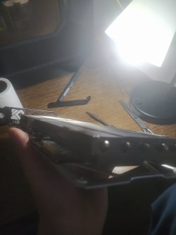

So, the first requirement, a flat surface:
Luckily, it's flat from a factory.

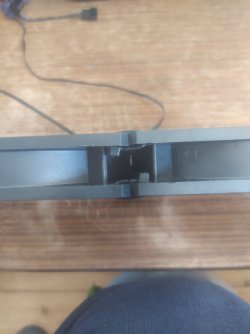

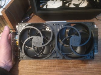

Two decent fans (Arctic P12 PWM PST), connected with a zip ties:

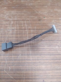

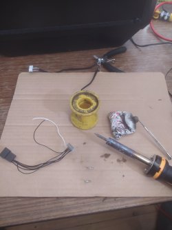

I've made a custom fan header/adapter, because I couldn't find parts to build one from scratch, or to wait a month to get it shipped from China. And OFC I didn't want to destroy the factory one. Not because I plan to sell anything, but because one day I might wish to assemble the card with all stock parts. This particular card is something special TBH. Cooling, design, RGB and everything else, including build quality is pretty amazing (for this tier anyway).
Soldering... Not that I suck at it, but my tools are kinda too hobbyish, IYKWIM.
But it gets the job done. I've found some 8-pin headers in the electric repair shop, know a guy, he let me search through his "soon to be trash" box of wires. Sacrificed one PST part of a fan, and another spare male header I had around for one of the pins:

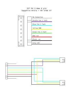

Got the diagram somewhere from Reddit long time ago. The only difference is that I've connected all PWM signal wires into one for obvious reason (one header):

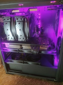

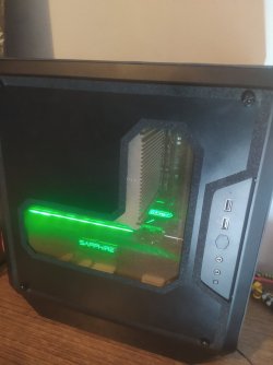

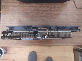

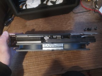

Final result:
IMG_20230427_192154.jpgIMG_20230427_192352.jpgIMG_20230427_192332.jpgIMG_20230427_192402.jpg
You've noticed that I've reused the LED logo from the shroud. Main reason is that the LED on the backplate doesn't work if the logo strip isn't connected.
Important thing to note, you shouldn't hook up fans onto just any spot on the card itself. Try to find the right holes, to prevent warping and bending the PCB too much. I've found the 3 perfect points, as they were already on the heatsink for connecting the shroud.
The fans are in the pull orientation, as it's going to The negative pressure build. Just another awesome trait of the deshroud mod: The ability to change airflow orientation with ease.
A beauty:

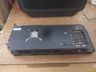

Now, the ASRock 6900XT OC Formula.
Flat heatsink:
And the rest is coming tomorrow. That's it for now, Good night.

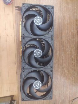

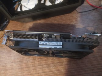

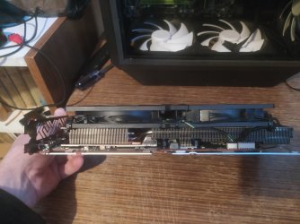

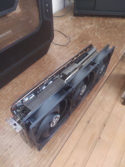

Decided to go with 3 fans:
Soldered the mini 4-pin header onto the standard 4-pin within one of the fans:
Chosen 3 points for a link to the heatsink, and that's it. Pretty simple and spartan, yet awesome in performance. Even at 1800RPM these fans are not loud. and the temps are excellent.

Due to some mistakes in my recent post, I got it removed and now want to bring a corrected version back online:
Hi all! I also want to showcase my deshrouded XFX Radeon 6950XT MERC. I got the inspiration from theborv, I basically copied his work on a 6900XT MERC. This is an awesome alternative to watercooling imo, since you don't break any warranty void stickers, the mod is easy to do and it really does reduce noise AND temps at the same time. The stock card was unbearable in terms of loudness for me personally, thus I always used the silent preset (-10% power target) in the AMD settings. Now it is dead quiet at the stock profile, and also bearable with OC settings.
Since there are not so many pictures of this process for the XFX MERC models, I decided to document this process in order to encourage more people to silence their XFX 6800-6950XT MERC cards. First, you need to unscrew the six screws between the fans. These were really tight on my card, so you should use a screwdriver that really fits into the tiny screw head and also apply some downward pressure while untightening the screws. Luckily, the LEDs on the card are wired to the fans, so you only need to worry about the single 4pin header while taking of the shroud. Also, the fans are screwed to the shroud, so the whole assemly comes of in one piece, making mods/repairs on this card very easy.
I next plugged an adapter into the card's fan header, so that I can hook the 120mm fans directly to the card. Alternatively, hooking the fans to the motherboard and using FanControl would also work fine. With the shroud removed, there is much less restriction on the side, where you normally have the illuminated XFX and Radeon logos.
I bought a kit that allows to fixate 120mm fans to a PCIe slot. Since the kit was only designed for two fans, I used both metal brackets on one side to hold all three fans together, and used zipties on the other side. The fans are the Arctic P12 PWM PST.
This assembly can be installed in the slot right below the graphics card, leaving only a small gap between the fans and finstack. A strap prevents the fans to hang ~1.5cm below the finstack at the right edge. Finally, I secured the cabling mess at the side and was done with the mod.
Now I happily use my card with the stock preset, the default fan curve also works surprisingly well with these fans.
View attachment 302585View attachment 302586
View attachment 302587View attachment 302588
