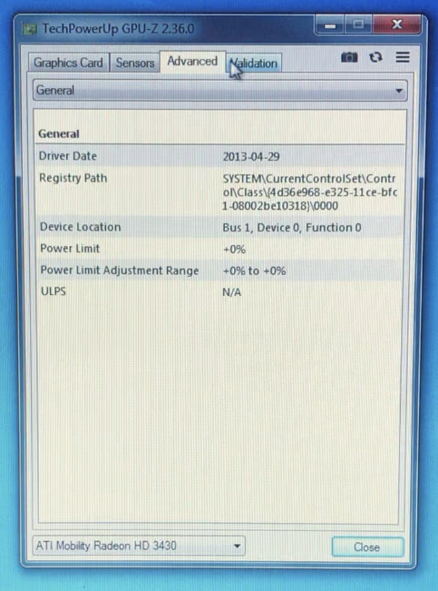

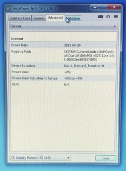

Hi again, i managged to enter gpu-Z and here are the photos

Ok, so the driver seem to work and GPU-Z loads. But this not much help. Not aware what utility you use to read the temps, but you can try HWinfo.
https://www.hwinfo.com/download/
Skip the lansweeper, click the green download box instead.
Check the "sensors" section within hwinfo.

Load is 0%, GPU fan @ 100%, temp 126'C , does not look good. Fan actually spinning at full rpm? Other than that, something is broken.
What is the make and modelno of the laptop?
