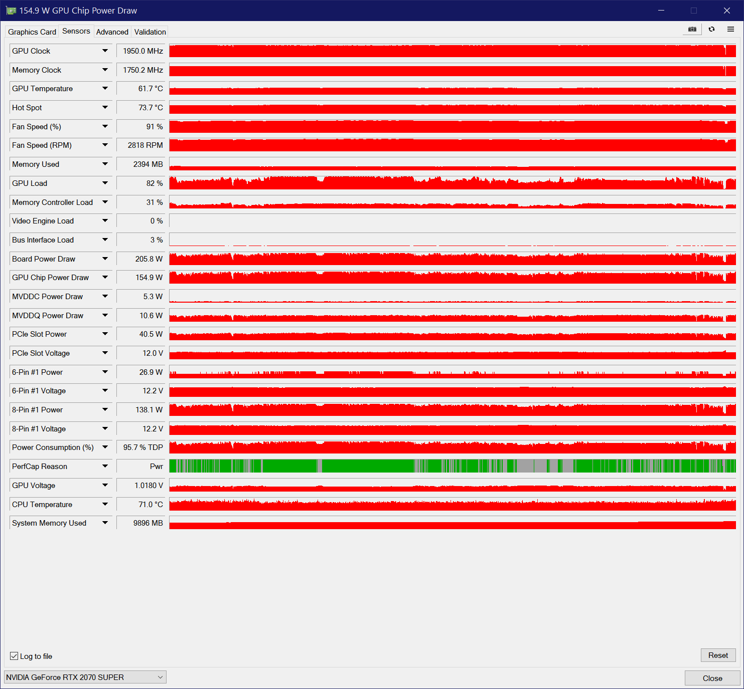

After I upped the voltage to CPU it didn't blue screen again. So I installed a new power supply. I now have the CPU voltage back to auto and I'm still not blue screening.
I have a screen shot now. I was playing game. Major slow down. Paused game and tool a screen shot of the graph.
On the PerfCap reason says pwr, thrm in red for a second.
I went for upping the power limit with Afterburner. This is what I got.

Today I was playing, I was getting slow downs some longer than others. You can see when it happens GPU load goes to near zero. Then game crashed. It took a bit to get back to Windows but I didn't have to reset. PerfCap showed none, it's in white. This makes no sense to me so if you have an idea I'd appreciate it.

I saw on another post here, Perfcap none means there is nothing limiting the performance of the card, but fps drops accompanied by lower usage can be explained by CPU bottleneck.
It seems by this post the GPU isn't getting instructions on what to do, a bottleneck. The game was waiting and waiting then stopped.
When I came out of game it took forever for it to recover. I was looking at GPU-Z for awhile. I took a snapshot and it took minutes before it would let me save it. GPU-Z was running fine. I was at desktop game was closed. I was getting the little blue circle like it's doing something. I hit CNTL-ALT-DET to close whatever was running. It hung and hung. When the window did show to name the file to save it. It was acting like a whole lot of things were running in the back ground. Super slow mo. I've noticed this before and to prepair I've debloated Win10. I found a program that deleted all the background apps and programs. What is odd though task manager never came up. I hit CNTL-ALT-DEL a couple of times. I have been noticing that when I have several tabs open, YouTube and Google. Like you are listening to YouTube and surfing. When I click back on YouTube it takes a couple of seconds before it will refresh what is on that page. Lately I've been checking memory with AIDA64. The numbers I get vary. Read, write and copy I've seen as high as low 50,000 and lows 35,000. Memory latency varies as well. 48. - 42.. I've had Windows check memory and it says good. I've bench test, maybe I need to do it for hours. A while ago I did have a fan go bad on MB heatsink. It was making a bad noise and when I put my finger on it to tell which one it moved a little over. Broke the fan blade off. It shock the hell out of the MB for a bit.
I'm kind of leaning to it's the MB. I can switch video cards with my boy. He may not want to give it back...Teens. He is using my old 1060ti. I'm not sure if his power supply can run it.
