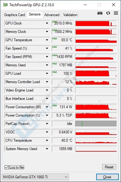

On the 1660 Ti the behaviour is...odd...in that PerfCap Reason constantly stays at Idle even though the card is under full load and overclock boosting to 2130 GPU and 1625 memory. I've never seen that before and I don't know if it's normal or possible!
If I drop power limit down to...90 or 80% then PerfCap reason changes to Pwr and the GPU clock obviously drops...
Is this normal behaviour or is it acting a bit odd?
Obviously it's reporting a PerfCap reason if I drop the power but even leaving Power limit at 100% and increasing GPU clock +160mhz to 2130 boosted and +500 on the memory so it's running at 1625, it's still PerfCap Reason Idle which...just doesn't make sense...Power Consumption % is pinned at 98% at W is 130.

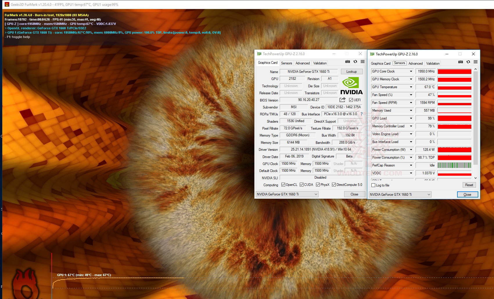

Sorry for the delay. Confirmed, this is the normal behavior, a bit strange indeed.

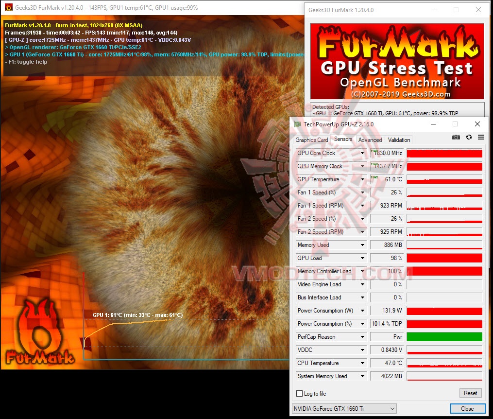

Board partners have no control over perfcap, NVIDIA has locked that tight.
Although the only perfcap reason i've seen anywhere on a 1660 Ti is Pwr...
Stop the fan with your fingers and put some load on the card, should see "Thrm" at some point
Did a quick test with ASUS GTX 1660 Ti STRIX, same behavior, always "idle" and "pwr"

Now that I am at my own computer, I tend to have Afterburner monitoring graphs on second screen. Names in Afterburner are a bit better - No load, Voltage, Power and Temp limits. No load/Idle is True when none of the other limits have been triggered, once some other limit triggers, No load/idle is False.
When GPU load is not maxed, it is common enough that No load/idle is still set. Basically at this point there is still some reserve performance available.
