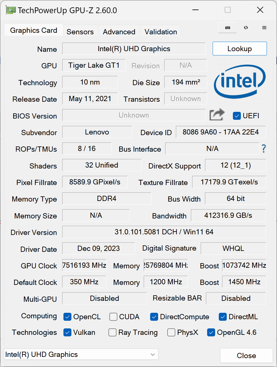

I took the below screenshot of GPU-Z:
But the built in GPU-Z screenshot upload became like this: (blank)

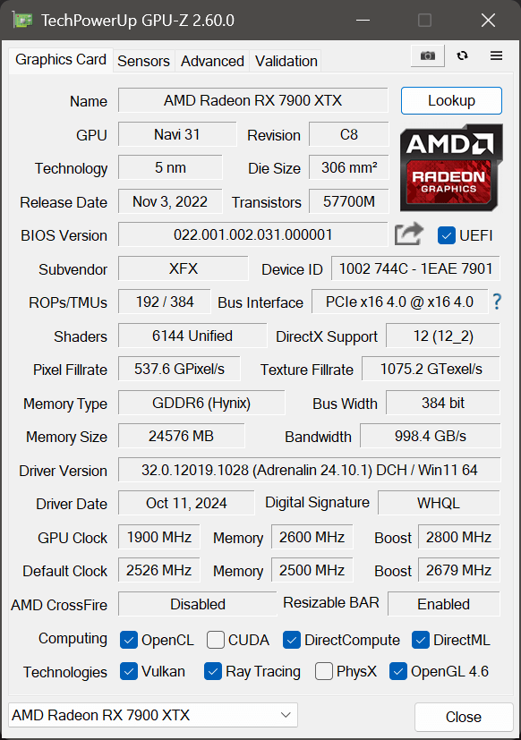

Can you try sensor page as well?
EDIT:This reading is from a machine with 2 monitors attached, External panel to Nvidia and Internal to Intel UHD, perhaps this is why readings are corrupt as well as unable to capture correct screenshot.
I reproduced the screenshot bug.
When captured from GPU-Z running on second monitor, connected to Nvidia GPU:
https://gpuz.techpowerup.com/24/11/20/j8d.png
drag and drop to internal panel connected to Intel GPU:
https://gpuz.techpowerup.com/24/11/20/ujr.png
