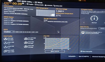

Ok, this is odd.... I installed the new sticks to the 2 gray (port 2 and 4), and powered the PC on. Upon starting, there is an orange light on the mobo, that then turned RED after about 10 secs or so. However, after about 1 minute of waiting, the monitor turned on and I could login to windows like normally, and now, there is a green light on it! Doest it mean that I have successfully done it, or?
But, WHY is the PC suddenly so incredible SLOW to bootup? It goes through the orange > red > blue > green light process again before it starts up. Takes about 40-50 secs.. which is TOO long! HOW do I enable fast boost again??
Is it slow to boot because the sticks seems to be mismatched? Because look at these screens and you will see that each of the sticks have different values. HOW do I fix that? :O Here are some screens that I hope will help:
Also, I put memory frequency on AUTO for now..

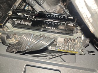

Also, here are the new sticks in place. Does it matter which port they are mounted into (grey or black), or?

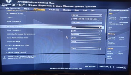

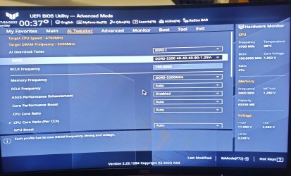

Also, I went into BIOS and changed the frequency from 4600 mhz to 5600 mhz. And I also see that my EXPO is turned off, should I enable it, or?
EDIT: Ok, WHY is it suddenly so incredible SLOW to bootup? It goes through the orange > red > green light process again... But that takes forever! HOW do I enable fast boost again??
Please read teh manual first. I provided you ASUS homepage, and the link for the manual.
Hint: page 1-12 -> Recommended memory configurations

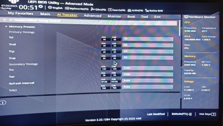

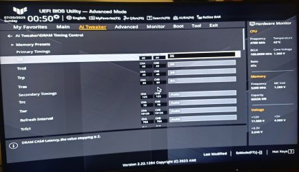

Please have a look on those Ryzen timings screenshots first.
Some settings need other settings. (Part of the answer. I'll not write use taht voltage with this and that as this may be dangerous when not knowing what you do. And where you do it.)
My DRAM will very often not boot on any mainboard when i raise just the MHz (these days called MT/s)

I suggest. CMOS Reset. Bootup with default values. DRAM should run with 4800MT/s (wrong labeled with 4800MHz -> rising and fallinfg flank of 2400MHz to be correct)
check with zentimings that DRAM is really only 4800mt/s default. Update UEFI; Update windows. Check if its stable (out of scope of this topic. there are several topics which cover this for e.g. windows..)
Than bootup uefi -> apply expo profile for
DDR5-5600​
something with 36-xx-xx-xx-xx for the timings
and check before you save and reboot that the voltage is spenning: 1.25 volt for the correct field.
You may download free software called zentimings (e.g. computerbase.de/downloads -> search for zentimings). And check if MEM VDD and MEM VDDQ is 1.2500V for your DRAM. This should bel applied by the mainboard itself when you load the correct expo profile, save and reboot. than enter again the uefi and check it.
-- Do NOT use the ai tweaker menu when you are fresh to the topic. I'm sure this UEFI has a begginer friendly version and an advanced mode. The uefi beginner mode should have less options. The uefi beginner mode should allow applying just the expo profile. I assumed the board behaves similar as my other msi and asus mainboards. Stay out of the overclock and ai tweaker options when you do not know what you do. Sorry - your questions indicate this in this topic. Screenshot shows this. Press F7 and go back in the EZ-Mode.

boot back into the bios, enable EXPO and go to the memory timings tab, around 2/3 down there is a setting called memory context restore which is disabled by default on ASUS boards afaik, enable this.
this will reduce the boot time by ~90% after the first memory training.
