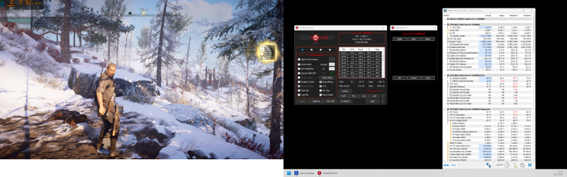

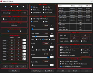

Hi everyone, i am newbie about undervolt. i read something about ThrottleStop but i dont know how to give value for undervolt to my laptop. i saw a video and gave same values but 2 times my laptop frozen on idle windows and than close undervolt from my bios and deleted trotterstop. Just i need to know which values is ok for my laptop. How can i give right values ? Thanks for ask and help.
Edit 1: I learned and i did undervolt with throtterstop program. I added my values. Please check on image. I have some when i check Limits. Idle time nothing happen but while i playing or test my computer( above 85 degree) start showing termals, PL1 and PL2 , EDP OTHER.

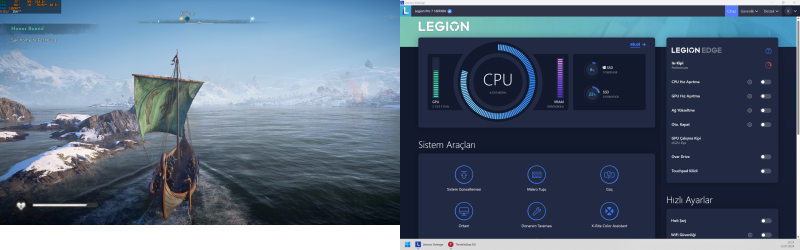

Edit 2: I added my game test images. Still too loud and hot my cpu even after did undervolt. How can i solve this ?
You have to experiment to find out what values will work best for your laptop.
Try setting mV Boost to 150. This might let you undervolt the CPU P Cache some more without your computer crashing. Try setting the P Cache offset to -75 mV or -100 mV after you set mV Boost to 150.
A laptop that has a 13900HX processor and a 4090 GPU is going to run very hot and the fans will make a lot of noise. Undervolting will only help a little bit. If you want a cooler laptop you have to reduce its performance. Is that what you want?
Open the TPL window and try setting the PL1 and PL2 power limits lower. Try setting them to 125W.
Less heat is good. Less performance is bad. You have to decide how much power and heat to run your CPU at.
You can also lower the Turbo Groups in the FIVR window to make your CPU run slower.
Maybe setting these all to 40 might be OK for playing most games.

Your screenshot shows that your CPU is going as high as 190.8W. That is why it is running so hot. Some 13900HX CPUs need more power and will run hotter. All CPUs are not exactly the same.
In the video the PL1 power limit is set to only 140W. This will reduce maximum performance but it will allow the CPU to run cooler during a long Cinebench test. Post a screenshot of the ThrottleStop TPL window. What are your turbo power limits set to? How hot is your room temperature? Are you using a cooling pad?
When he starts testing with Cinebench, his CPU is only running at 4.1 GHz. It is throttling. It is not even close to running at full speed.
At 140W in Cinebench, the CPU package is at 85°C. HWiNFO shows only 3.80 GHz. It is throttling more when the power limit decreases. HWiNFO does not report accurate MHz when a CPU starts to thermal or power limit throttle. It is obvious though that 140W is not enough power for maximum performance from a 13900HX.
why his the laptop cold?
When he is testing in the video and the Nvidia GPU is active, the CPU power consumption is only 71.8W but the CPU temperature is already up to 82°C. These laptop computers run hot. When his computer is running Cinebench at full power, his computer runs hot too. A 4090 GPU running at more than 170W puts a lot of extra heat into the laptop case.
Did you try adjusting mv Boost and lowering the P Cache offset? That has helped many users with these hot running CPUs.

My room temperature is 24 degree and im not using cooling pad but i start checking cooling pad which one is quieter. I dont know how to set "turbo power limit". i can do if you tell me how to do. PL1 and PL2 i set 125 as you told me. should i set 140 ? No need maximum performance from the cpu. Cause cpu is already powerful for 2k ultra gaming. Also gpu same. What really matters is how can I make my processor run cooler?
By the way my laptop runs cool enough if i set balance mod on lenovo vantage but performance drops by 30-40 percent as i understand from fps while testing games. thats why i am trying to undervolt.

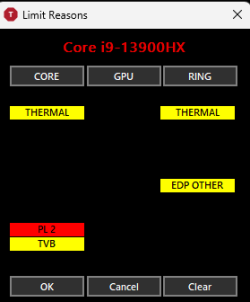

Actually i need to open hidden setting on my bios but i couldnt. I did some research and tried some combinations but it didn't work. Maybe need to change AC/DC in Cpu setting if i find how to open hidden settings. I think this option will work. By the way PROCHOT offset setting work well. stuck max 80 degree and fans working less noisy. I need to ask 2 small question. i appreciate if you answer.
1) Is there any problem on my limits or everything ok ? I bought my laptop used one and invoice date is 1 year ago. that is, it has been used for 1 year. Should i renew thermal paste ?

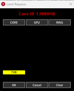

Lowering the turbo power limits tells your CPU to power limit throttle. When you see PL1 or PL2 lighting up red under the CORE column of Limit Reasons, ThrottleStop is telling you that your CPU is power limit throttling. This confirms that your CPU is doing what you have told it to do, throttle.

I do not think your temperatures are any worse than any other similar laptop when it is allowed to go as high as 190W. Laptops with a 13900HX and a Nvidia 4090 GPU cannot provide maximum performance at only 80°C.
That is good to know. Adjusting PROCHOT Offset is a good trick that not many people use.
