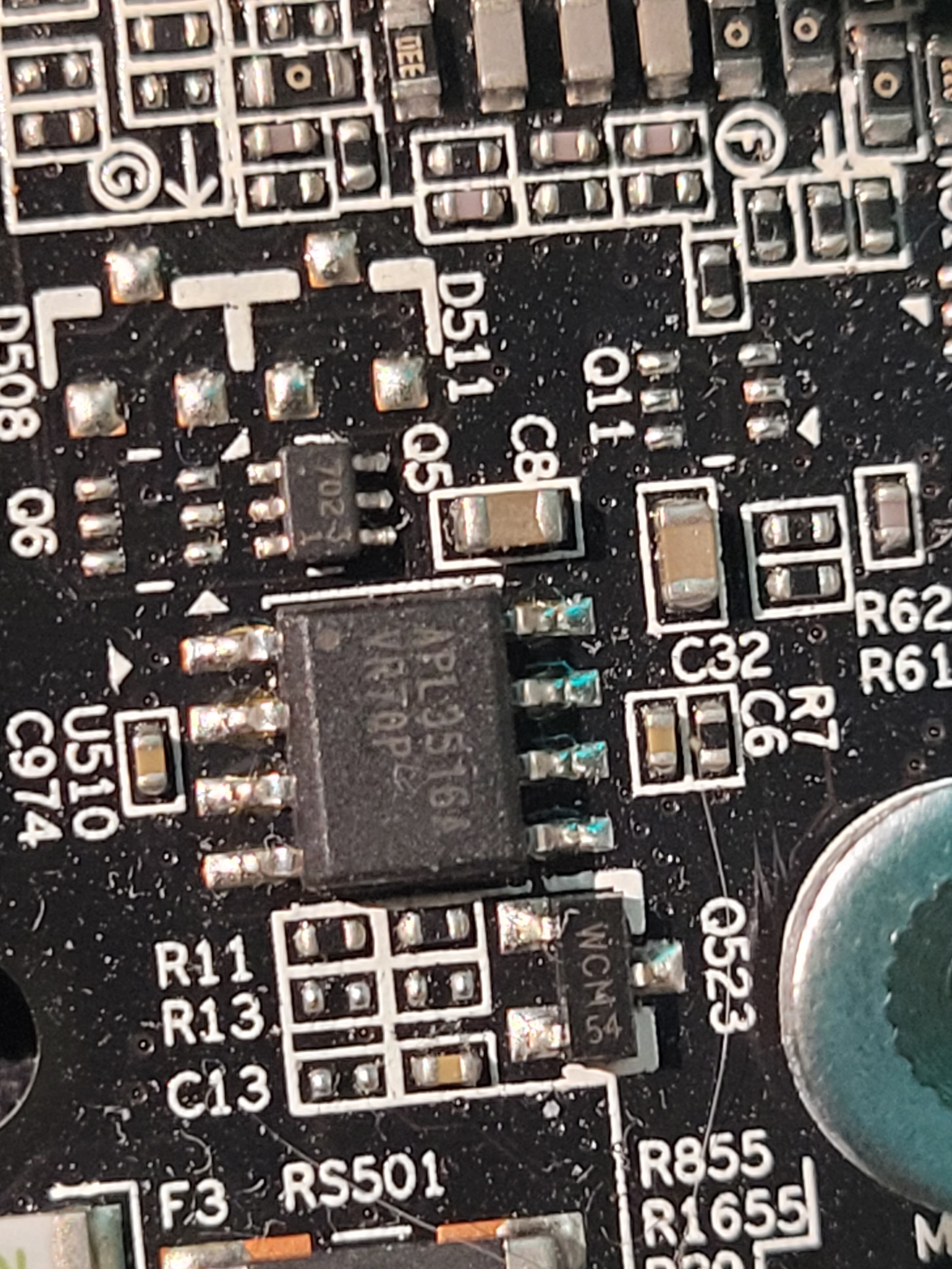

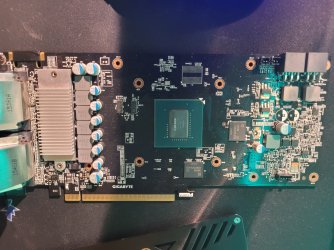

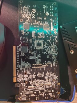

So i got a modify GTX 960, the card i have is this one :
Which make no sens, so i want to unbrick my GPU, i got a CH341A to make a flash but i need to find teh VBIOS chip of my GPU.
I found those 3 chip that looks like VGA BIOS one but can't find them in AsProgrammer.
If you can help me it would be great !!

The chips you have photographed are not eeproms. Beyond that look for other 8-pin chips and google the numbers on them.

You can read more then. It should have “25” somewhere in the name. For unmarked proms you will need to make educated guesses. Starting with the more popular brands. For things like winbond with multiple revisions, starting at the parent usually the smartest way forward.
Aug 27, 2023
302 (0.51/day)
If you check 2GB board seems much the same except configured with lower density VRAM.
Unfortunately back picture is not clear enough to read chip package text but quite often firmware chips can be marked with paint.
So looks like 2 VBIOS chips. Can you read the chip text on your board?
Check datasheet for voltage and that of the programmer. Is this a non-working board you bought to fix or can you run it in the PC? If can run in the PC can try "nvflash64 --check" to possibly list selected EEPROM.

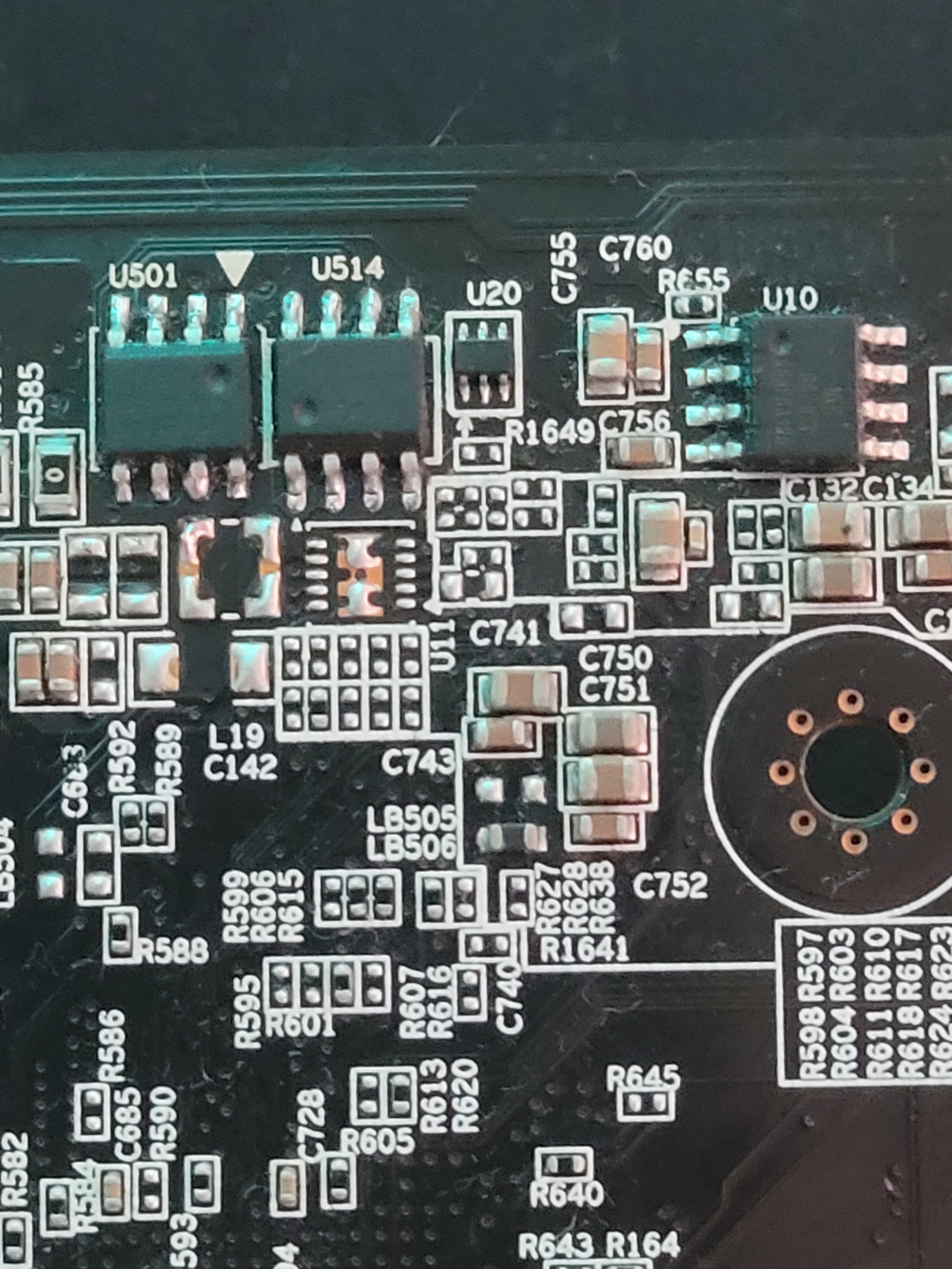

It seems like you have tried every chip and every chip isn't the VBIOS eeprom. How have you eliminated each one? What is written on each one?
Give us a clear picture of U10, U501, and U514.
Otherwise, hidden under the heatsink?

A bit of digging shows a review for the 2GB card
For this card chips appear to be GigaDevice GD25Q21, 2Mb (256KB) 2.7~3.6V although you shouldn't assume the same and check.
Here is a better picture, if it can help :

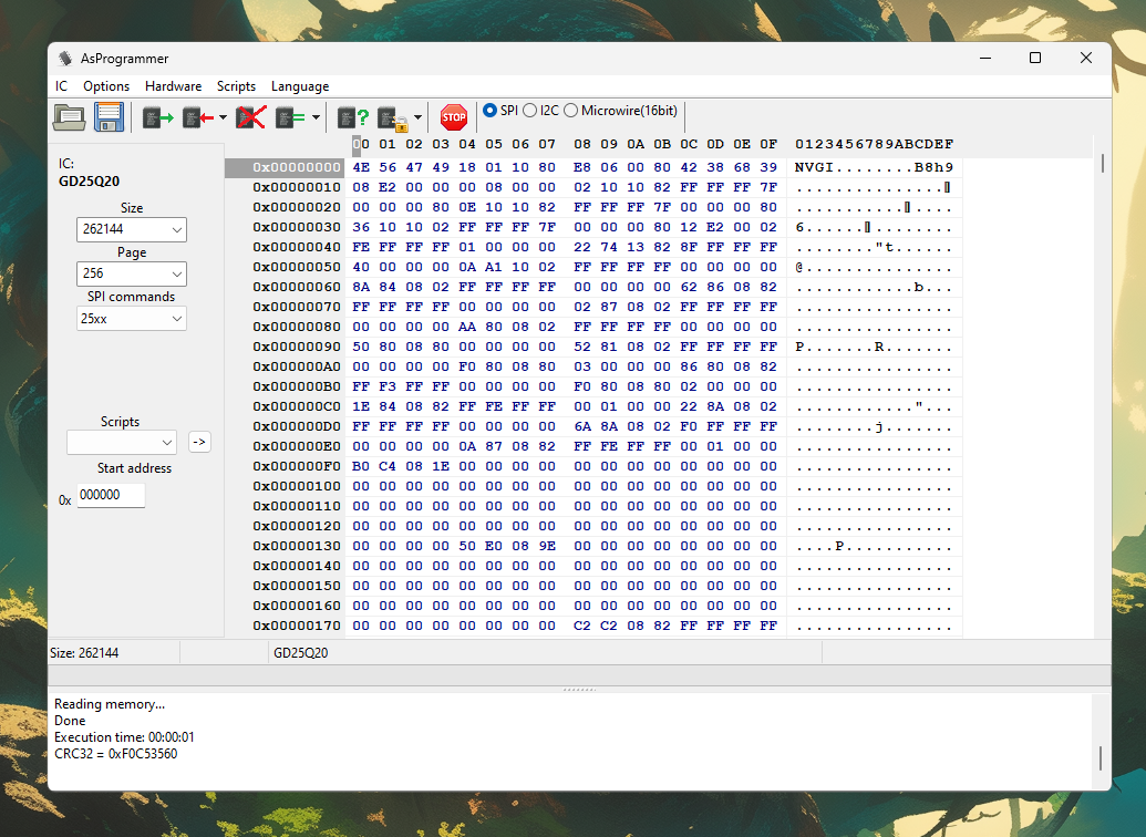

I just tested with GD25Q20 and found that i think it's the right one thx dude !!
Lunnyx
Aug 31, 2024
7 (0.03/day)
Bruh i got exited to fast, when i open GPU Z to check if the flash work...
Spoiler : I still a EVGA BIOS :(
I tried on the pink chip, i will try the white one to see if it's working

So which BIOS is selected appears to depend on what display connector(s) are made and each VBIOS is slightly different as to which connectors are active. It's an old post and some parts/links are unfortunately broken.

I already ask to the gigabyte support and there is no dual VBios on my graphics card
It's obvious you have a dual bios Gigabyte card of which whom are famous for including a back bios on everything that never seemed to work properly on any motherboard or video card.
The reason why is because it's designed for the failure of the OC bios chip which is not meant to be flashed. The recovery bios doesn't get activated. This procedure can take up to 30 seconds to activate the backup bios.
You really should follow the comrades advices given in this thread. You need the factory shipped bios flashed to both eeprom chips.
You know the 2 bios chips are true. The little arrow tells you how to orientate the programmer clip. These are janky, you must clip it on square and evenly. The eeprom chip needs power. You can install the card and turn the board on. This will power the eeprom chips. Leave cpu eps connector unplugged so the system doesn't post.
Anyhow, do your research as instructed and commit task to memory and good luck!

"No NVIDIA display adapters found" message from nvflash typically means that GPU has some hardware problems not related to VBIOS - maybe power-circuits problems or some damage related to PCIe connectivity.
I think so because GPUs even with desoldered VBIOS IC are listed in device manager as not-properly-working devices and are detected by nvflash as "NVIDIA gpu without ERPROM". But your case seems to be "no NVIDIA gpu detected at all" this looks more severe problem then VBIOS

The only think i know about this GPU, is that he got modified to work on a Mac Station.
