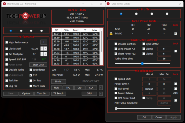

Gigo
Apr 28, 2024
7 (0.47/day)
Did you change Speed Shift in TPL?
This seems strange since the maximum value should be 50 (5.0GHz) corresponding to the maximum clock rate of the P-cores.
What must be allowed on this CPU is to limit (decrease) the maximum clock and not increase it.
What is the value of PL1 and PL2 in performance mode originally?
I attached the default settings

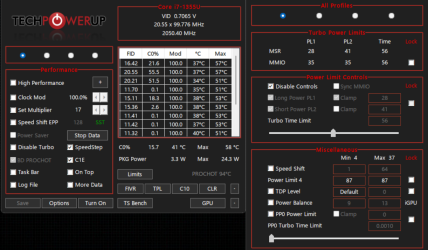

Hope I understood the suggestions correctly
  • 2024-04-29.txt
unclewebb
Jun 1, 2008
7,400 (1.27/day)
Your settings look OK. Does EDP OTHER still light up and stay red during your Visual Studio projects? There is some occasional EDP throttling but with no access to the FIVR or IccMax settings, there is nothing you can do about that.
