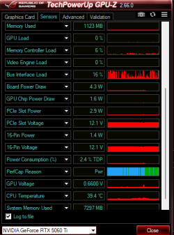

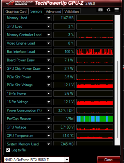

Hey. I'm sorry for reviving an old thread but i'm having some similar issue. My gpu is on idle but my perfcap reason is always like this alternating between perfcap pwr and VRel. Even tho I'm not doing anything. My GPU is 2 days old

You're running 4-7W idle, that GPU really isn't being used any more than it should be. Changes like this can be normal. Do you have the 16GB variant?
Yes I do. Asus Prime 5060 ti OC 16GB. It's weird that it's jumping between those 2 states. Pwr and vrel and as soon as I hop into a game I always have vrel on and power it's fine.
I really don't see any reason to worry. It powers up properly when under a load and idles super efficiently. Do you have any performance issues with the card?
I mean I think it should be pulling more watts in certain games but I don't think so. What worries me is that they are switching between those two states on idle and then only vrel on any game. But comparing to the screenshots posted above seems like everyone is having the same issue
If it's sub-10W at idle and >150W under load then it's fine.
The reason the driver caps the power is complex. GPU-Z gets a code from the driver, but only Nvidia really know what's going on under the hood. So long as utilzation and power draw are in the right ballpark, I wouldn't overthink it.

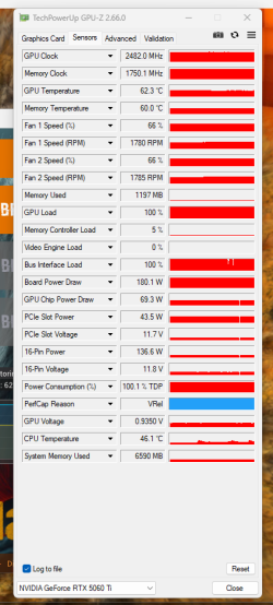

That's the problem it rarely gets over 140w. It stays at around 130w in the last of us part 1 maxed out. I only play 1080p tho.

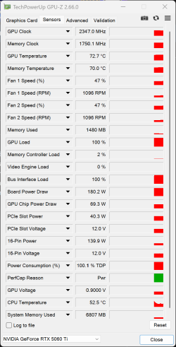

Try Furmark to make sure your card can actually draw 100% TDP, and it's not some vBIOS/power delivery issue at play.
My Prime 5060Ti is installed right now so I can give you what I get. No games seem to hit 100% TDP, most hover around 90% for some reason - I guess in those workloads the 5060Ti doesn't need its full TDP to hit max boost and max voltage (see below - vRel is the PerfCap reason once I turned off vsync, but GPU utilisation is at 100%)
Furmark and gaming GPU-Z screenshots below.
View attachment 408224View attachment 408225
First of all thank you for taking the time with this. Can you check if your gpu gets Perfcap power on idle and as soon as you open a program or click something you get perfcap vrel for a bit then back to pwr? Sorry for the trouble.
I get 180w on furmark, on occt 3d adapt extreme as well, only tried continuous which draws the max wattage. But on games I hover around 120, 130w. The max I got was control with everything maxed out which got me 150w.

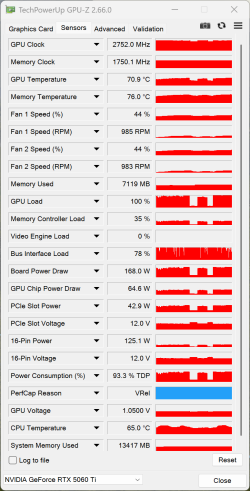

Just got home so I had some time to do some more testing.
On the left its my GPU at furmark, on the right its after 30min of playing indiana jones and the great circle maxed out. Keep in mind i game only at 1080p

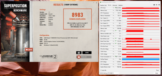

Mine's always showing PerfCap as VRel, even at idle.
I ran Unigine Superposition on the 1080p Extreme benchmark preset for you, I picked that because you can download and run it for free to make comparisons.
This is an old AM4 system on PCIe 4.0. Gigabyte X570 running W11 24H2. Everything is bone-stock, and the Asus 5060Ti isn't a factory OC model.
