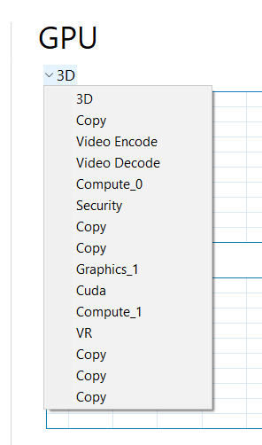

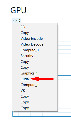

Also, Blender needs to be setup to use the GPU, it doesn't just do it out of the box. The other thing with Blender is that Windows Task Manager by default doesn't show the load of Blender. You actually have to click on the little arrow next to "3D" in Task Manager and then select "Cuda" from the drop down. That will then show you the Cuda load on the GPU, which is what blender uses.
In the Task Manager, It doesn't give me an option to view the amount of "CUDA" processing.
The "utilization" value in task manager seems to show what HWINFO names "GPU D3D usage"
Check "GPU core load" in HWINFO or "GPU load" in GPU-Z.

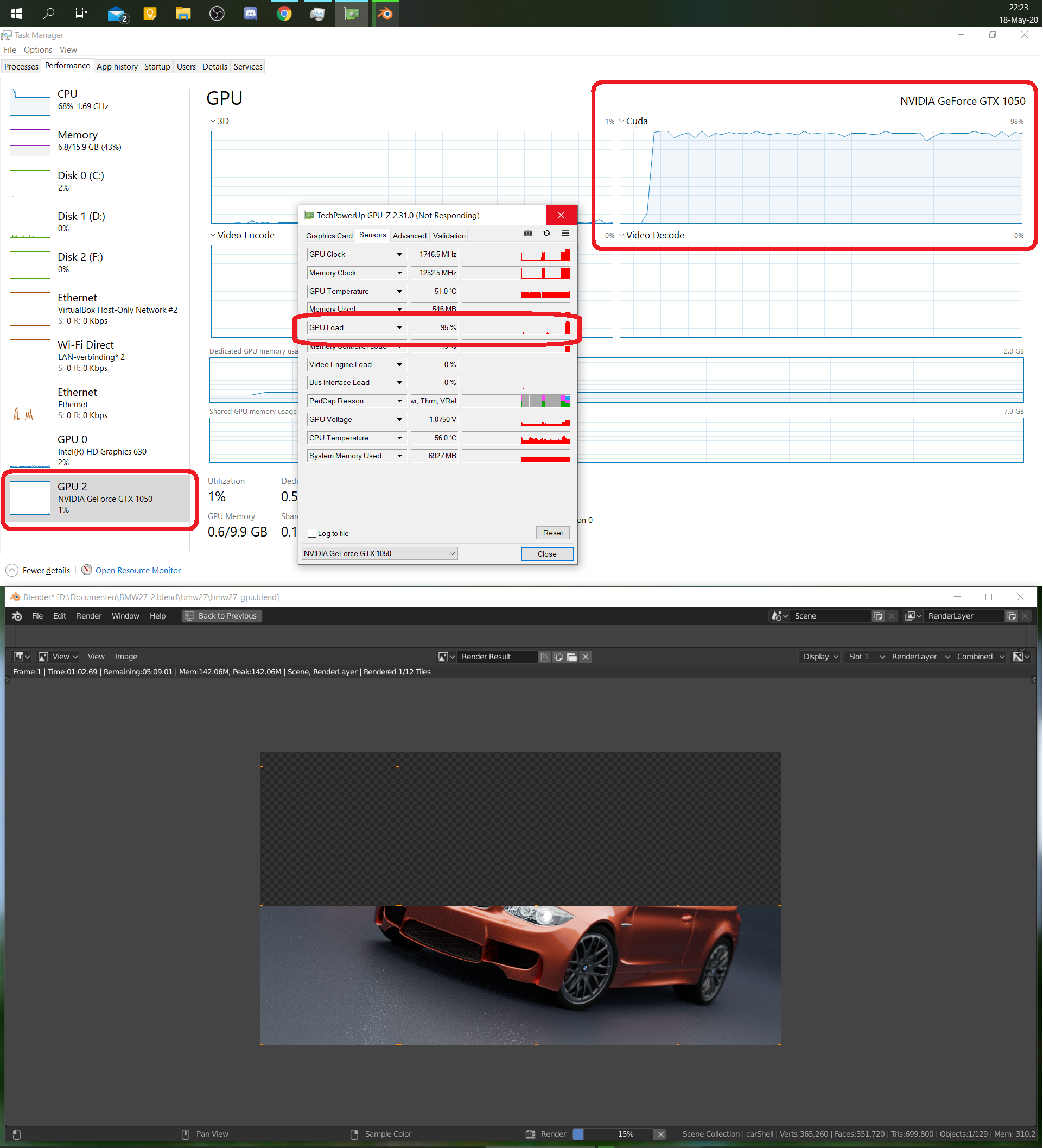

I tested Blender again, and indeed it works just fine, but the task manager just doesn't display it.

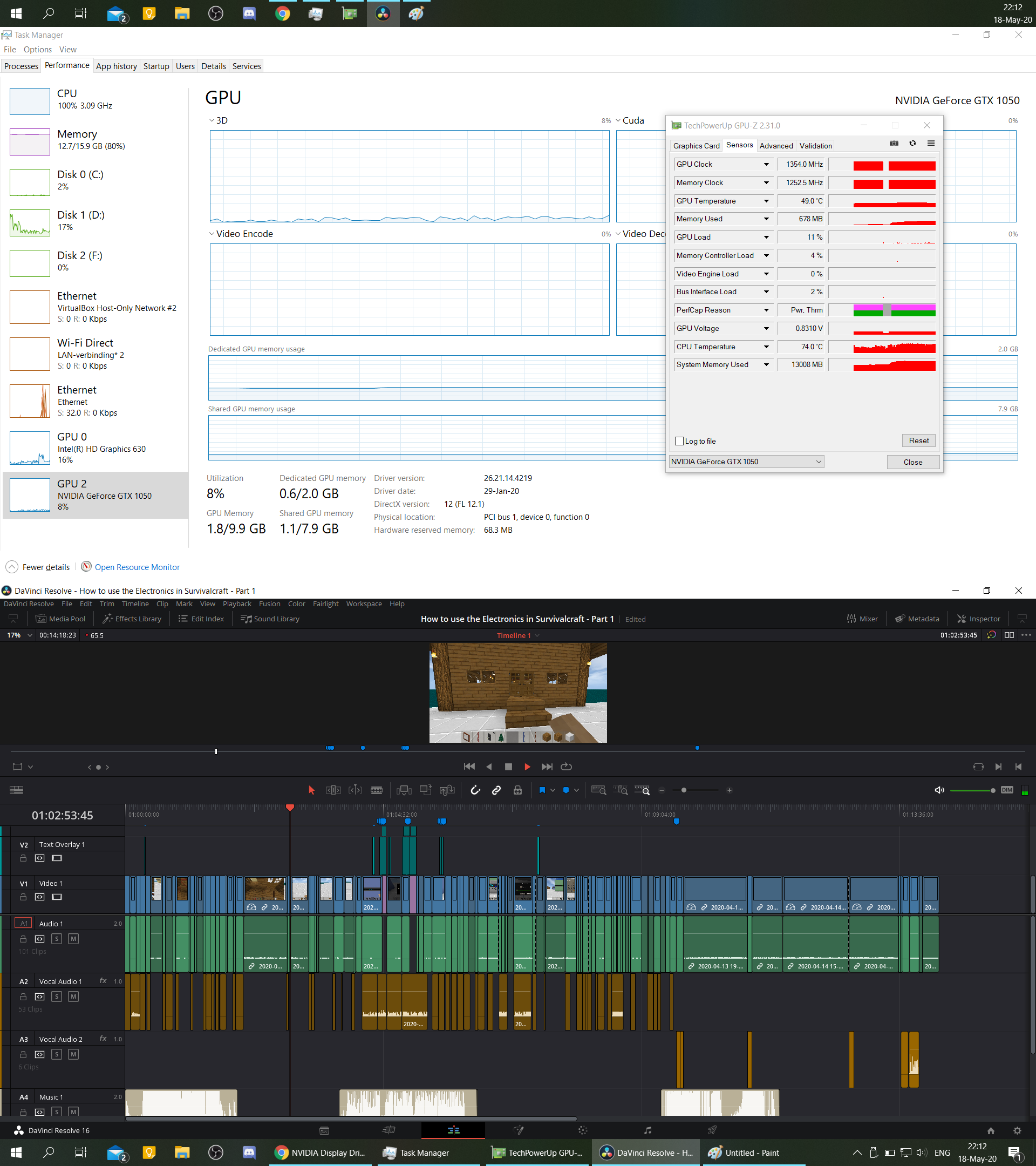

But DaVinci Resolve still doesn't seem to use the GPU a lot
So, probably there's just nothing wrong with my gpu, but UserBenchmark and resolve just don't like using it a lot.
