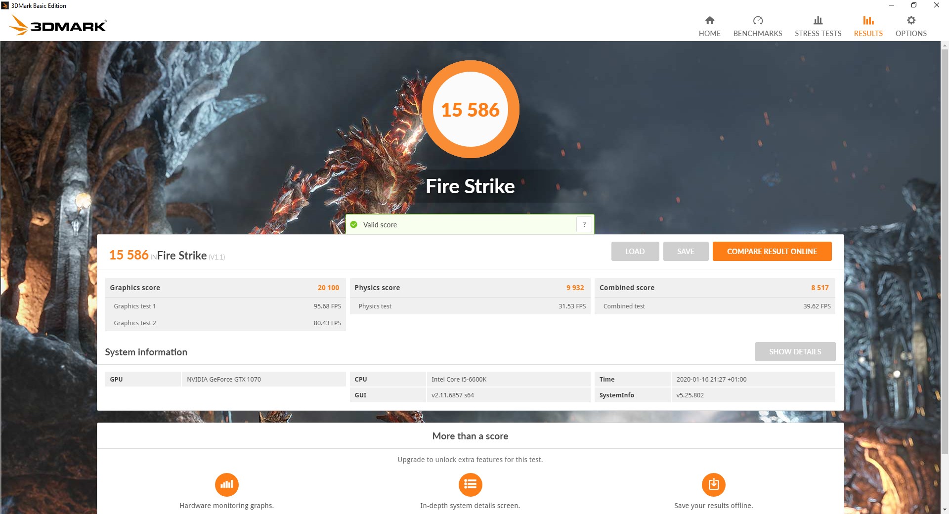

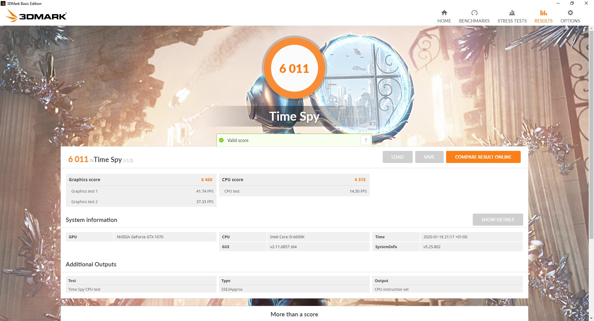

Sorry I have 3DMark demo only so I can' t run that test. I did Timespy and Firestrike both in MSI mode and INT mode. But it is as I though no difference (at least not noticeable) in FPS. Driver used is 441.87 DCH.
