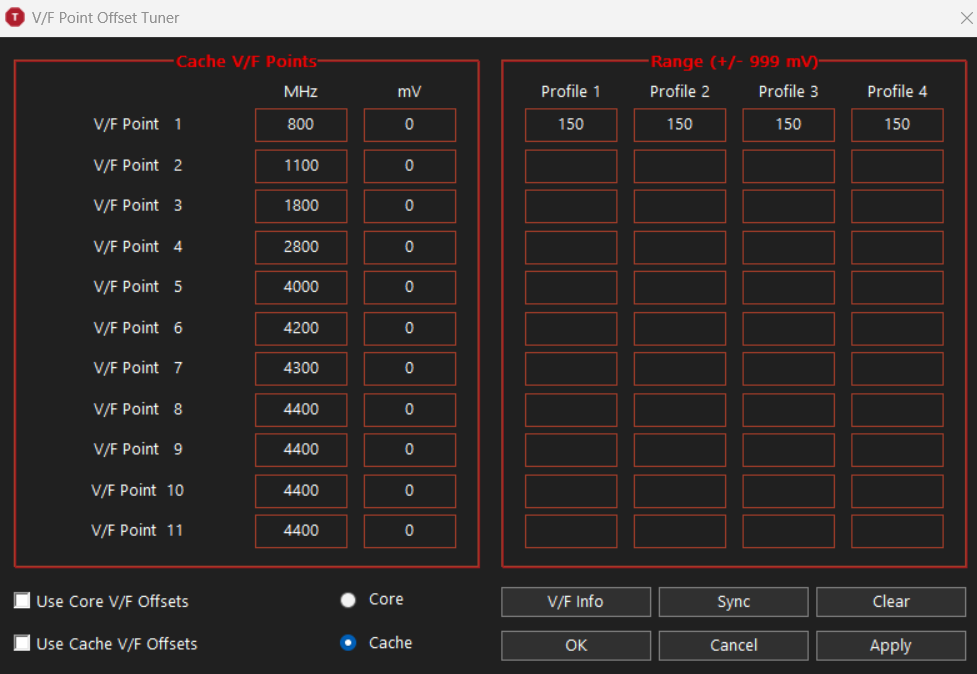

Open the FIVR window, press the V/F Point button and set V/F Point 1 to 150 for each profile. Do the same for both the core and the cache V/F offsets in this window. It should look like this.
Press OK.
In the FIVR window set the CPU Core and CPU P Cache to a negative offset value of -125 mV. I am using offset values of -150 mV. For you, start conservatively and set both values to -125 mV. Play some games and see if your computer is stable. If everything is OK, you can try increasing the undervolt. If your computer crashes, decrease the undervolt. Undervolting the HX processors is not rocket science.

Is That True? Should i check the Use Core V/F Offsets and Use Cache V/F Offsets ?
Yes.
It does not work unless both of those boxes are checked. My screenshot shows that both boxes are checked. This should be done first.

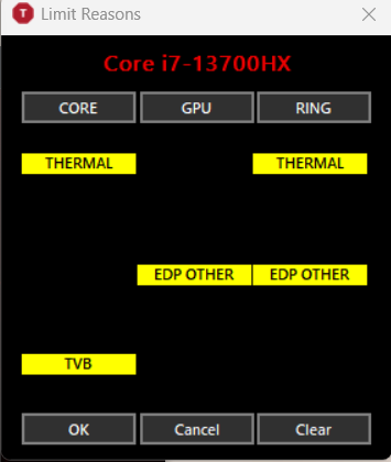

Thanks, the system seems very stable at the moment. But I'm asking out of curiosity and to really learn these things. Why didn't we undervolt the E cache? Also, do I need to make any other changes or will these be enough? I don't need to change anything other than just finding the correct offset value, right? Also, I get some limit errors, but thermal errors are normal since I haven't changed my thermal paste yet and TVB isn't that important to me. I'm also afraid that removing EDP Other might damage my device because I'm not in very reliable temperatures and sometimes the system needs to limit. I guess there's no big deal about that either. But I still wanted to ask you

To get rid of TVB throttling, try clearing the Thermal Velocity Boost box in the ThrottleStop FIVR window.
Some EDP throttling seems inevitable. I set Power Limit 4 to the max, 1023 and I set IccMax to the max, 511.75, for the CPU Core, P Cache, Intel GPU and iGPU Unslice.

You are welcome. An undervolt that is 100% stable is more important to me than trying to come up with the perfect settings that might crash if the sun comes out that day. Did reducing the voltage help with your high temperatures? Often times it does not make much difference. Lowering the voltage will lower power consumption, and this will allow the CPU to run faster. Do not be surprised if the temperatures are exactly the same whether you undervolt or not. Anything under 100°C is the new normal for gaming laptops.
