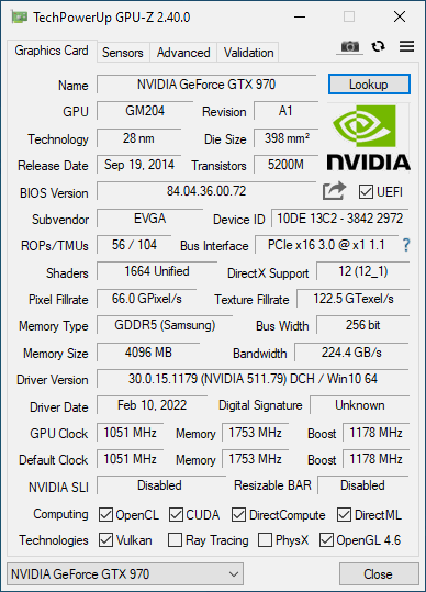

I have 2 gpus (1070ti , gtx 970) so I stumbled upon few articles and videos regarding DX12 Explicit multi-adapter rendering, which make use of multiple GPUs that don't have to be the same model (unlike SLI)....so I thought I should make use of my second gpu (GTX 970) and installed it on the second PCIE slot (Motherboard manual states that the second slot is 8X, while the 1st is 16X both version 3.0).....now GPU-z states that my 1st GPU is running at 8X v 3.0, which is understandable given the multiple GPUs situation and they have to share PCIE lanes
what puzzles me is that GPU-z states that my second GPU (gtx 970) is runing at PCIE x1 V 3.0 , and it even switch to v. 1.1
What could be the cause ? I tried forcing PCIE link speed to gen 3 in bios, prefering maximum performance in Nvidia control panel, even forcing kboost mode in afterburner but nothing changes

edit: tried reseating the gtx 970....now gpu-z reports that it is running at x8 v3.0 but it drops to v1.1 after few seconds...tried running the render test of gpu-z but it stays at 1.1

Dropping to PCI-express 1.1 is normal behaviour for idle state of the card. Run render test in GPU-Z (or more demanding graphics program) and it will go up to 3.0.
Even when I run the test it stays at 1.1

It shows 3.0 in your second GPU-Z screenshot. Maybe it's just not big enough of a load that GPU-Z Rendertest. Try some other windowed 3d applications and see how high it goes.
Feb 27, 2022
31 (0.03/day)
it seems you are right...once launched ashes of the singularity in windowed mode ,then launched gpu-z, now it reads x8 gen 3.0....only thing left for me is to figure out does this setup benefit me more or running a single gpu (1070ti) on pcie x16....
