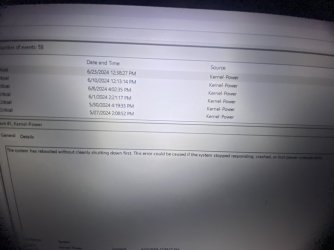

Laptop Event log shows
Error Id-41_Kernal power error.

The Power button cable was cleaned and all.
Since it’s working fine repair guy said no need to replace it.
ATM i am using Malwarebytes App to check for any Malware’s
That only means that the operating system was not safely shut down, happens when you yank the cord or take the battery on with the machine live. The power-on button actually closes a circuit that turns the system on (this is the reason why you can turn on a desktop motherboard with a screwdriver, for example), and having the charger plugged in probably prevents the circuit from closing somehow.
I still think a physical inspection is in order, to at least see if the system is reassembled correctly. With water damage existing, the problem could be as simple as a resistor that has some corrosion in or around it.

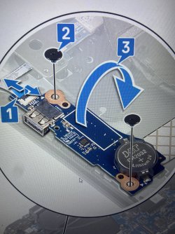

Hi.
I asked the repair person what he did after getting the laptop to work.
He said he found a corroded resistor, he took it off and cleaned it and welded it back on, after that the laptop turned on.
Most damaged area was attached in the photos.
Cable noted as 1 is the power for power button he found corrosion on it and got it cleaned.

Hi Everyone i came back with an update. basically the repair guy says no damage is found on the MO and it might be a BIOS AC behavior issue.
Because he replaced the Cion battery and that Auto reset BIOS configuration.
from dell repair manual: "CAUTION: Removing the coin-cell battery resets the BIOS setup program’s settings to default. Before removing the I/O board along with the coin-cell battery, it is recommended to note the BIOS setup program’s settings."
If he removed a Capacitor and soldered it back on the wrong way it would allow current from the battery to power the system back on without pressing the power button I would imagine as they are generally one way.
I could be totally wrong too,and welcome more experienced replies.
Get him to have another look at the repair he did and test it.
He did solder back a resistor and i thought of that and told him, he is sure he did it the right way.

Regardless, I don't think this is BIOS-related. It's definitely not the default setting even if this is available on your laptop (and I am fairly sure it is not on mine - a 2021 G15 5515)
Well he did a full inspection on all damaged
( were water went ) hardware and he found non.
Taking it to other shop I feel like they will try to rip me off in sense of trying to make a short cut regarding the power supply that will cause harm any time.
The main guy i went to, suggest it it possible to make a jumper wire and make it work but it’s risky.
