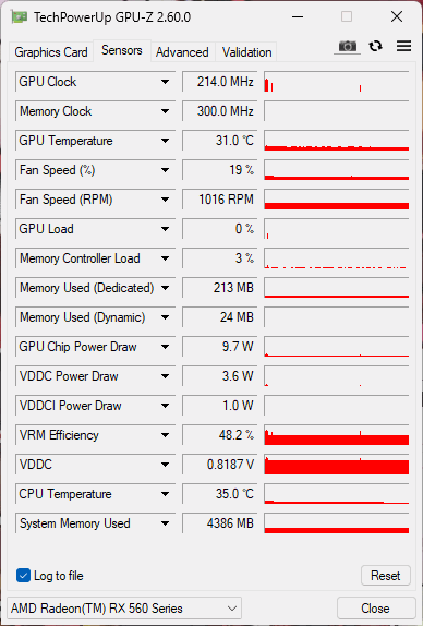

I've been having similar problems like Skeptical. This usually happens whenever I'm not running a program that requires 3D acceleration and while idling. My GPU was at 31C before the crash then it increased to 35C a few seconds before the crash occurred according to my log. Here are the things I've already tried:

I also discovered in the Event Viewer that it also detected a display driver error: "Display driver amdkmdap stopped responding and has successfully recovered."

UPDATE: I applied the TdrDelay in my registry and set the value to 0, but the GPU still crashes. Sometimes the GPU crashes and reboots, and it wouldn't even have the amdkmdap.sys error. It sounds like it doesn't make sense, but it's still a GPU related error.
