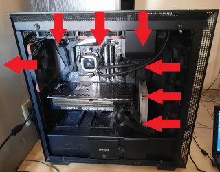

Hi guys! so I'm looking to buy a new case focused on the best airflow, I watched GamerNexus video about the best 22 cases and they say one of the best is the Lian Li Lancool 2 'Performance'
The problem is that I need one with support for a top mount 360mm radiator.
I also would like to know any suggestions for my current fan setup airflow wise, I'm thinking to replace the front fans (they are 3 years old now) for 3x200mm fans (noctua ones) or maybe 140mm that you guys recommend. I tried with the top fans as exhaust but didn't make much improvement for the gpu/cpu, it was actually worse for the cpu temps.
current setup is:
front: 3x120mm 1500rpm
top: (radiator fans) 3x120mm 1400rpm
back: 1x140mm 1800rpm

This is more how it should be.
Having 6 fans sucking air in means there is almost zero airflow, your one fan exhaust is like trying to push a grapefruit thru a garden hose.

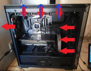

If I would like to use the radiator on top, should I use those for exhaust as well? when I tried last time I just saw the water temp way higher. Also the one exhaust I have its a 140mm fan around 1700-1800rpm

keep the radiator in the front otherwise you'll just heat up the Water with your GPU by a lot for maybe 1-2°C lower GPU Temps at best.
in my H710 it was a LOT better for the CPU and the top exhaust with the radiator in the front gives you some negative pressure and the GPU stays cool.

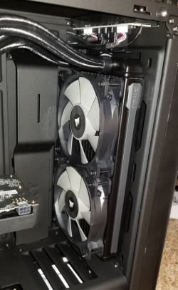

thanks I'll try that, does the fans need to be like this? (like, not 'after' the radiator)
fans are better in pushing air rather than pulling.
pushing from the outside through the radiator gives you slightly better cooling, pulling air through the radiator is easier to clean.
i'd go with push. (the fans on the picture are wrong)
ah ok then should be like: radiator>fans>front
I'll try that configuration and use exhaust on the top, I'm having high GPU temps lately maybe because of that, my 2080 wasn't even close on the temps.

The Lian Li Lancool II has a newly-announced successor, the slightly larger Lancool III which can accommodate both 360mm and 420mm radiators on the top.
The top as an intake makes zero sense. You are fighting physics since hot air rises. This is likely why your GPU temperatures are high. DeathToGnomes has posted a photo annotated with a good airflow.
The Lancool models have a removable front radiator bracket so the order should be (L to R): case interior < radiator < bracket < fan < mesh front panel cover
If you get one of the Lancool Mesh cases, I suggest you install fans on the PSU shroud exhausting up toward the GPU. This will suck cooler exterior air through the bottom mesh door and increase airflow.

I saw the Lancool III, I think I'll wait until that is available here and buy that one since I like the support for the 360mm radiators on the top. I'll have time while I wait and just play around with my current case and try the suggestion from GerKNG, that could change my mind and just use front radiators from now on :p
