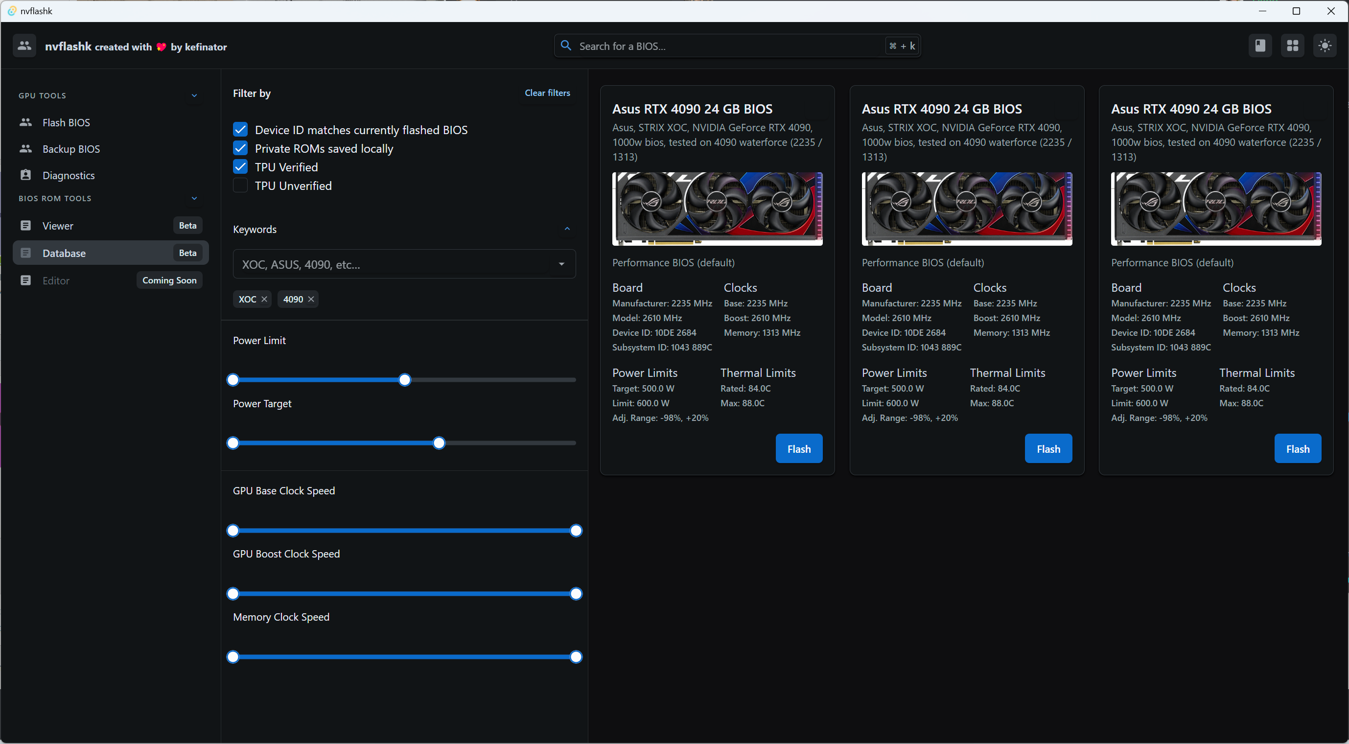

Preview of the UI and database search tool coming later this week..!
Have fun, and keep an eye on those thermals!
Awesome work with the flash tool.
I'm curious to know, is the GUI frontend a native compiled application or Electron?
Aug 20, 2023
33 (0.10/day)
Thank you! It’s a Tauri app, which is basically Electron except it has a Rust backend instead of NodeJS, and it uses webview instead of the gigantic chromium. I’ve used Electron a lot for some crazy stuff but for a small utility I found it overkill, and Rust also will be able to deal with the low level systems stuff without the need for intermediate native node modules.
I'm familiar with the Tauri ecosystem.
Have you considered Delphi?
It would give you the low level power, quickly putting a nice UI together and compile a self-contained, no external runtime needed executable :)
