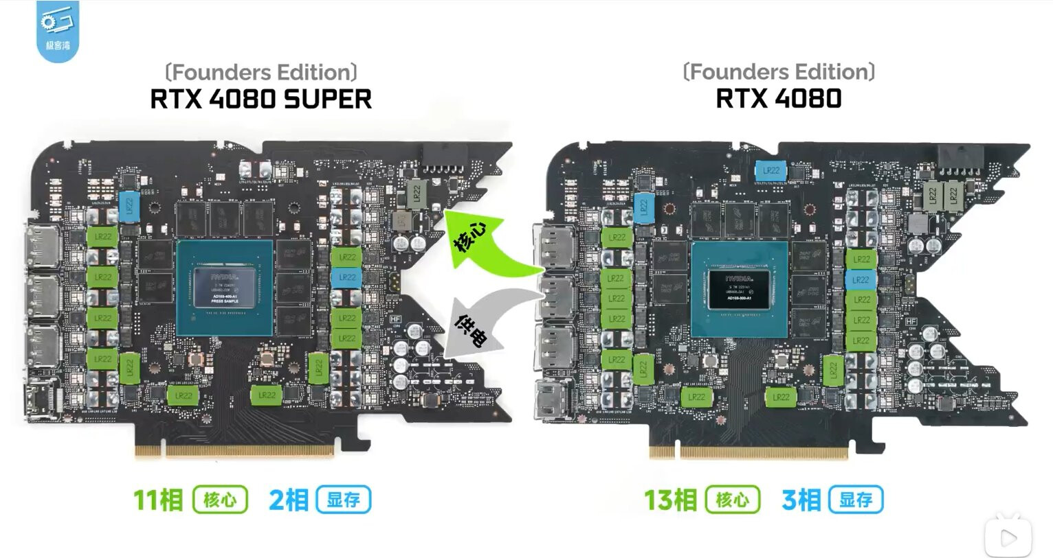

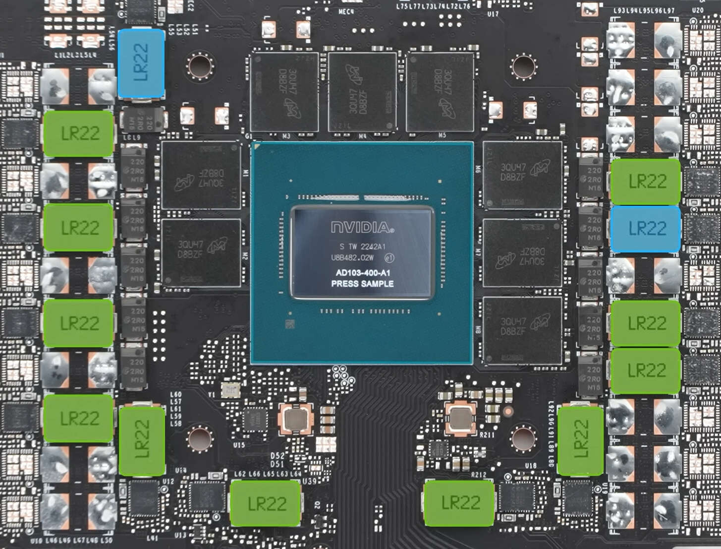

A video review has highlighted some curious internal changes on the NVIDIA GeForce RTX 4080 SUPER Founders Edition graphics card—Geekerwan has discovered that the board design has been "updated" to a small degree, when cross examined with the non-SUPER variant. Team Green engineers have chosen to decrease the number of phases from 13 to 11, while the memory phase count goes from 3 down to 2. HXL (@9550pro) TLDR-ed the situation on social media: "4080 Super FE vs 4080 FE: Core: -2 phase & VRAM: -1 phase." Tech experts have also noticed that the new SUPER FE's board does not have a phase near to its power connector. VideoCardz found these changes to be a little bit odd, considering that the card arrives with faster memory and a increased core count.
Geekerwan reckons that NVIDIA has implemented these internal adjustments in an effort to reduce power consumption in gaming scenarios. The official comparison table confirms this ambition—in the "Average Gaming Power" category we see the GeForce RTX 4080 SUPER target 246 W, and GeForce RTX 4080 (non-SUPER) aim for 251 W. The reviewer notes that their ASUS ROG STRIX RTX 4080 SUPER GAMING sample card features the same power layout as its non-SUPER sibling. They believe that NVIDIA's Founders Edition is the only model bearing an adjusted phase tally—while Team Green's board partners have simply rolled out the previous RTX 4080 layout.
The GPU codename has been revised as well—specifically for review sample purposes. VideoCardz points out: "As noticed by the same reviewer, there is also a small change to the GPU codename, the RTX 4080 SUPER is labeled as PRESS SAMPLE. Typically, reviewers receive early silicon from initial production batches, often labeled as "QUAL SAMPLE" or they have no labels at all. This is the first time NVIDIA has used this new label, presumably only for its Founders Edition. As far as we can tell, this wasn't the thing for RTX 4070 SUPER, while 4070 Ti SUPER and all previous releases (4060 Ti/4060/4070 Ti) did not have a Founders Edition design; hence such a label was not present." The "AD103-400 PRESS SAMPLE GPU" label is visible in this screenshot:

This "news" is garbage. Are they comparing the specific components used or just throwing number of phases around? 5W is nothing, card to card variance alone can be higher than. Are they opening up all the cards sold so far? Chances are they did this change months ago in the regular model as well because of anything really, could be a cost optimization or simply component availability for example
Like who gives a shit, phase count was always a marketing point and a bullshit metric, AIBs often use it to try and convince people something is better but it's a meaningless number on it's own.
But chance of increased coil whine?
Or maybe reduced because there are less coils to whine? :D
It can vary wildly, without further analysing the board design you can't really tell anything about what it could mean
Yea, I was considering that view point, too. :) But to my logic less coils = more stress on the remaining coils. At least that's the experience as far as I can remember. But unless @W1zzard or someone else does a noise analysis we will never know. Somehow those tests sadly still aren't on the check list of any reviewer, making GPU purchases still a lottery.
Also just compared the reviewed 4080 Super's and the number of power phases do not translate into power consumption. So there are more variables at play that influence the power draw (BIOS, clocks, etc.).
[11 phase][13W pwr idle][302W pwr gaming] NVIDIA GeForce RTX 4080 Super Founders Edition
[11 phase][14W pwr idle][304W pwr gaming] PNY GeForce RTX 4080 Super Verto OC
[12 phase][13W pwr idle][324W pwr gaming] ASUS GeForce RTX 4080 Super TUF OC
[12 phase][20W pwr idle][306W pwr gaming] Palit GeForce RTX 4080 Super GamingPro OC
[13 phase][23W pwr idle][304W pwr gaming] MSI GeForce RTX 4080 Super Expert
[13 phase][28W pwr idle][334W pwr gaming] Zotac GeForce RTX 4080 Super AMP Extreme Airo
[16 phase][24W pwr idle][297W pwr gaming] Galax GeForce RTX 4080 Super SG
[16 phase][16W pwr idle][312W pwr gaming] Gigabyte GeForce RTX 4080 Super Gaming OC

Exactly, it can vary wildly, a lot of stuff goes into the design of these things. Less coils can be more stress on the remaining coils if they're using the same components, or less if they bought higher capacity ones. Higher number of phases can also mean they're using the cheapest crapiest components so they need a lot of them to meet their power target, or they found a nice deal bulk buying the same components used in cheaper cards. Or maybe some guy from the marketing department came to the engineering floor and asked them to go nuts with a very high number of phases because higher number = better in marketing materials (that asus strix oc and gigabyte oc come to mind)
