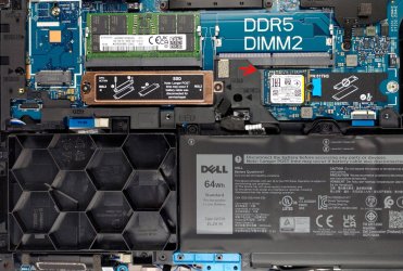

Hello, I own a 12th gen Dell Precision laptop. I recently upgraded its storage with a 2 TB WD Blue SN580. I specifically picked this model despite it lacking a DRAM chip, as I was worried about overheating. According to its datasheet, this model barely passes the 5W mark at maximum load (and it was also among the cheapest in my country in terms of capacity/cost).
My laptop has two NVMe slots: one is close to the GPU (which comes with a copper heat sink provided by Dell in the slot) and the other has no mounting screws for a heat sink and is located right next to the fan exhaust. I chose to plug it into the one closer to the fan exhaust, as Dell manual specified that it gets less heat. Everything is fine when the fan is working, but for instance, right now I am simply browsing the web, so the CPU is below 50 degrees and the fan never spins up. Despite not doing anything involving IO, what I assume to be the NVMe controller board gets extremely hot, even at a low-power state. According to the other sensors in my laptop, none of the other components are above 50 degrees, so this is most certainly its own heat. I don't understand; I thought these NVMe drives did not need active cooling.
I don't know if it would be any different with Windows, as I don't have it installed, but I imagine it would be the same case without the fan spinning. Any suggestions? For reference, I'm attaching a photo of the laptop's internals that I found online.

Both you and me misunderstood the situation and the pic. It shows the original 2230 Kioxia SSD, but that one was later replaced by a 2280 SN580. The SN580 doesn't exist in 2230 size!
But regardless, that SSD comes without as much as a graphene sticker. I'd try a sticker (graphene/copper/combination) first because it's designed to distribute the heat over the entire surface of the SSD, over a distance of a couple cm, so that the entire surface becomes a half-decent heatsink. On the other hand, a thermal pad's job is to move the heat away from the SSD, over a very short distance of 0.5 mm or so, to the metal object it touches. That's why a thermal pad with no heatsink on top wouldn't have much effect.
To the OP: I took a look at Aliexpress and you can get several M.2 heatsinks designed specifically for Precision models. Try to identify one that would fit your laptop. Just guessing here: it may be fastened at the right side with a screw, and at the left, by locking under the black plastic edge that the red arrow is pointing at, and next to the "M2L3" mark.
Also, have you consulted the user manual? It's unlikely that Dell designed the right M.2 slot without an option for a heatsink.
