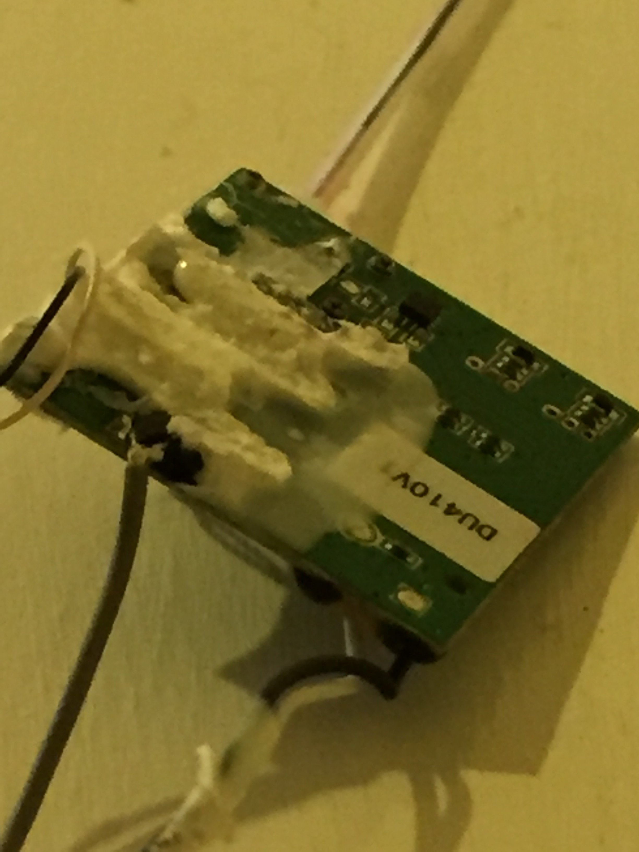

Hi. I'm new here, hopefully I can get some good help and I'll probably stay around :p.
I'm gonna try and keep this background brief and short, but it still may be a bit long for some. Sry!
I'm an RC hobbyist, and was salvaging electronics from an old model plane to put on a new airframe. Unfortunately, I accidentally tore motor wires off the control board while doing so. No problem right? Just solder it back on? Well, I decided to ask a friend to solder it back on while I painted the frame. It should've been fine, but later as I was testing the electronics, I noticed the motor (the one that had the broken wires) still wasn't working. Then I noticed a small, what looked to be a flame under one of the components. It was sort of an orange/red glow. After disconnecting the battery (which I ruined while frantically yanking it out) and putting out the flame, I noticed that the component had been burnt and blackened. I also noticed the crappy soldering job my friend had done (wish I had noticed it before the test! :p).
So yeah. Now there's a blob of solder (Yes, the crappy soldering job cause the wires to fall out again) and a fried component on the board. Is there anyway to repair these? If so, what tools will I need? I have no idea what part this is, and it's very small, but I can provide more details if needed. Only to the extent of what I know about the board though. (Photos attached)
Ty
-ETPOF
Quite probably yes, you can just replace the fried component, after cleaning up the soldering job. Looks to me like the solder is bridging contacts between two or more pads on your output for sure, and quite possibly elsewhere.
The issue is going to be whether or not that guy took anything with him when he went... That, and your own skill with an iron but if it's broke, there's no harm in trying (I suppose beyond possibly damaging a motor or battery you hook up to test it).
Look around the whole circuit board for other damage or melty/scorched bits, and blobby solder; especially any that looks like it might be bridging adjacent pads. You'll want to make sure there's no remaining short circuits anywhere or other damaged components, delaminated traces, etc before attempting a repair. If you've burned through or delaminated any traces you may need to solder in jumper wires to replace the broken trace but I doubt you'll have that much damage, that all looks to be power supply circuitry and pretty beefy traces as far as the part of the circuit that was involved in the incident but I can't say for sure.
Next, you're going to need to get the numbers off that guy and look up the datasheet online to be absolutely sure of what it is, then you can order them from any number of electronics suppliers. To actually get it off the board you can heat up each lead one at a time and use the solder sucker to get the majority of the solder away, then gently (Very gently) pry up on that lead you've melted and sucked away the solder on, and allow it to cool while you're holding it away from the board. Hopefully enough distance that there's no remaining solder connecting the lead to the board when you're done, but it makes more sense to go around the chip a few times slowly working it up than to try to pry it up all at once and pull a trace off the board. Really, lift is what you're trying to do, more than pry.
As for tools, a solder sucker and a soldering iron with some fine gauge electronics solder; perhaps a magnifying glass (one mounted on a helping hand is usually easiest), a pair of tweezers and a steady hand can get it done. Soldering picks are helpful for many things, including lifting and prying on things to get them apart. If you can get your hands on a temperature controlled soldering iron it will make your life a lot easier. A hot-air desoldering station would probably be easiest but I sort of doubt you have one lying around ;)
I know there's guys on the forum with more experience in PCB repair than myself, so I'm sure one of them will be along sooner or later to give some tips.

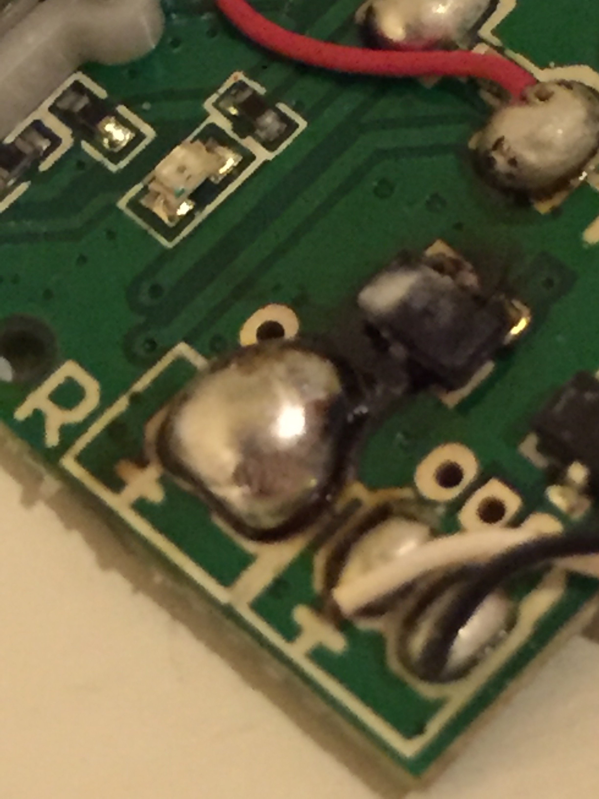

And I did inspect the board for any other damage. I didn't see anything except for a small burnt spot directly above (or to the top right of in the photo) the burnt component. This spot looks to be on a small blob from soldering other wires, so should it be fine? Here's another photo for clarity (actually it's just zoomed in on the original :p)

Well, I'm 99% sure of the cause.
The board wasn't built by me. It has worked fine in the past. The only damage done to it was the wires being ripped out and then the bad soldering job as a result. Come to think of it however, could this have also damaged other parts of the board or even the motor? Even the battery felt hotter than usual during the failed test, so that is a possibility. I guess I'll see what happens. Thanks!

The cause is almost certainly the short circuit caused by the gigantic blob of solder on the output...

Yeah, unfortunately this could have fried your motor and battery. It could have taken out other components on the board, too, but there's usually visual signs.
Chances are, however, if I'm correct about the cause - then that chip was likely the only thing short-circuited, and it probably destroyed itself cutting the circuit and saving everything else. (that, or it could have destroyed itself in such a manner as to dead short the circuit, which would be bad, but it's far less likely in my admittedly limited experience.)
Your battery would have seen a high, but probably not catastrophic load. Check it carefully for melty looking areas. Especially the wires. If the insulation is melted, you probably don't want to be hooking it back up to a charger or load. You'd have to cut off the melted section and re-wire the pack, at least, if that was the case. Chances are the cells themselves are alright (LiPo cells for RC use are both high-current capable and generally protected - They can handle fairly high current and - if protected - they'll break the circuit themselves if catastrophically-high current is experienced - which may render them unusable, or they may be able to be reset by either time or applying a charge for a few seconds, depending on which protection mechanism was tripped, if any)

I would say 98% chance that guy's toast. You don't generally get smoke and flame out of an IC and have it still survive. EDIT - I re-read the OP. He said it appeared to be a flame. My bad. Still, incandescence is not a great sign.
Digikey, Mouser, and Newark disagree with you. 99.9% of these ICs are off-the-shelf parts, and a few cents to a few dollars apiece. Shipping usually costs more than the part itself.

well a sucker is great for removing "all" of the solder for unsoldering things, but for removing "excess" solder (blobs) without removing all of the solder, holding it upside down and using gravity to remove all but the correct amount of solder is the best way.
I solder things every day so im good at it but even still on a few occasions in need to "clean up" a few solder joints.
a good tip is to use a wet sponge in a saucer to wipe off the flux buildup on the hot solder tip if it gets dirty, but then your not doing 100 solder joints on ever board like I do.
what is the part number on the board? i couldnt find it by lookingfor a 1434 Receiver Board so there must be another number that identifies it. have you looked into the cost of getting another board? just curious what those things cost, im thinking these are generic boards used in most stuff that cant be more the $10 I would think
He has all the numbers he could read off the board listed in his... second? post with pictures. I couldn't find anything based on them on google or horizon hobby's site, but maybe you'll have better luck.
The only thing I was able to find was what looked like a newer version of the same board, and it was listed at $49.99 or $59.99 iirc.
Flux was the other thing I meant to mention but forgot. You think a Flux pen would be worth it for a single smd ic? What kind would be the other thing.
yikes !!! I was hoping that little thing was $5-$10 so no harm in destroying that one but that's a little chunk of gas money at $50
I don't bother with flux, I just always use electronics grade flux core solder but after a few dozen solder joints you need to wipe off the excess that builds up and starts to burn and turn into carbon buildup on the tip

This all seems to be related to the same problem of finding the part numbers, so I won't bother quoting.
I've been experimenting for quite a while (broke another motor wire off while doing so :/. Oh well. More soldering practice, I guess, right?) trying to take photos of the piece, but iPhones clearly aren't the best method. I'll be trying a Samsung next. My iPhone close-ups are either blurred, or too far away from the piece, making the top look flat. m4gicfour, may I ask what smartphone you used? It appears that you have an attached lens, or just a really good macro camera.
Besides that, what I can tell you is that you're correct about the component functions. The two components seem to correspond with the two side-by-side motor outputs below them, where the wires broke off. The board controls a small, twin engine plane that uses differential thrust. The Duet to be exact. It was my first plane and the airframe is now garbage, so that's why I decided to salvage the electronics. Don't tell me to buy another only because the board is nearly as expensive as the plane because I think fixing it myself will be a more fun and interesting solution! (Unless of course it becomes aggravating and not fun) :P.
Besides having to deal with the motors being placed on separate sides of the airplane (and therefore they might be programmed slightly different to account for the differential thrust), the outputs and their components should be identical. I could try to call Horizon Hobby and see if they can tell me the part in the meantime.
...and about $2 of PCB or less in bulk, with $1.50 of parts on it :laugh:.
That's about what I thought, but I don't do a whole lot of SMD soldering myself so I don't bother with flux either and figured you might either confirm my thoughts, or tell me about how fantastic flux is and why would anyone ever not use a flux pen. Good to know I'm not crazy.
Besides that, what I can tell you is that you're correct about the component functions. The two components seem to correspond with the two side-by-side motor outputs below them, where the wires broke off. The board controls a small, twin engine plane that uses differential thrust. The Duet to be exact. It was my first plane and the airframe is now garbage, so that's why I decided to salvage the electronics. Don't tell me to buy another only because the board is nearly as expensive as the plane because I think fixing it myself will be a more fun and interesting solution! (Unless of course it becomes aggravating and not fun) :p.
Well, that's promising. The fact that they're identical outputs means that so long as each of those semiconductors is wired identically into each channel, there's a very good chance that they are, in fact, exactly the same part.
Contacting HH might be a dead end, but it can't hurt to try.
Samsung Galaxy S6, stock camera. Even using Samsung's camera app. Heck, I even shot that through a Lifeproof FRE (which is junk, unfortunately, but it's "waterproof" so it has a clear plastic window over the camera, which should theoretically lower quality).
I mean it when I say lighting is critical. The samsung camera goes fruitloops and fuzzy as all heck if the lighting isn't perfect.
You'll probably want manual focus if you have the option. The samsung app will autofocus on whatever you tap on, on screen, which is a nice feature.
