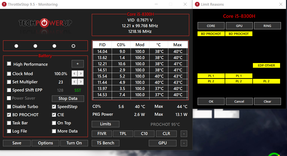

Hello everyone! I have a problem that I've been struggling with for quite some time - Limiting the frequency during games to the minimum values. At first, for some reason, I sinned on outdated Windows, drivers and BIOS, but after updating the BIOS / Installing Windows / lack of drivers for chipsets, the problem remained, so I think this problem has been with me all my time. I recently found out that Throttle Stop can solve this problem and started experimenting. Experiments did not lead to anything (Although undervolting to -125 and increasing IccMax seemed to have paid off (Frequency increased to 1500) + I also experimented in TPL, but after that there was a crash. There are no problems with temperatures, the laptop does not heat up above 65 even in games (And with a limited frequency, the temperature is somewhere around 45). У меня HP pavilion gaming 15 cx-0027 (I5 8300H, Nvidia 1050ti, Charging at 150 watt).
When the laptop is not loaded PL1 and the rest of the indicators are in yellow.
When the laptop is under load (tested on games, for a long time), the frequency drops to 800 PL1 in the CPU and the GPU turns red. Also flashes red in RING Edp other and PL2 in CPU and GPU
What settings can I try to remove these values ( the power in thottlestop rarely exceeds 15 watt, usually value ~ 3-4 w)

Start by clearing the BD PROCHOT box on the main screen.
Post pictures of the FIVR and TPL windows so I can see what options are available to you.
Turn the Log File option on and attach a log file to your next post so I can see how your computer is running.
Check the MMIO Lock box in the TPL window.

In general, I climbed, searched the forums, randomly made settings in the trot stop, but it doesn't help. I understood that the problem is that I almost always have the Power Limit turned on and it limits my processor very much, reducing the power to 3-5 watts

I`m try it, it doesn`t help

Here are two more logs. On one I played without folding the game, on the second I folded it
Have you checked the MMIO Lock box yet? Also clear the Disable Controls box.
Your computer has a power limit throttling problem. Check the Device Manager for the Intel Dynamic Tuning driver. You need to uninstall that driver and block it from being reinstalled. Check Google for details.

No, its not help. I`m install windows 10 v1703 and installed all the necessary drivers, but I still get power limit throttling. For the sake of experiment, I installed Intel XTU and it shows me a CONSTANT power limit
