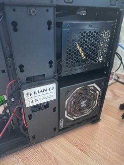

So, almost new psu was upgraded:
Stock fan is 130mm, I did not find any replacement, so decided to use my 120mm favorite Noctua NF-A12, but issue that fan is PWM, but I am engineer :)
Decided do not put again this plastic cover, because new fan will not blowing air to mesh.
And I am very happy with result
Connected PWM cable to Octo controller and setup curve, but before created virtual sensor that getting wattage from cpu + gpu and will use formula for transfer watt to %.
So, I have in "office work" 400-500 RPM on PSU and my Mora radiator and during playing in Cyberpunk (12600KF+RTX4090) my system load will be 550W and 700-800RPM in PSU, very quiet and no weird logic for fan curve as it used for Super Flower.

Another approach might be to change the case fans so that there is positive case pressure and so air flow through the power supply even when the supply fan was off; this should stop it kicking in at low loads.
It also means you can retain the original fan, as the replacement may not have enough flow for full load.
The baffle was also there for a reason.
The original fan looks like 2 lead, but the replacement was 4 lead (and smaller than the original).
I'm also very confused about the case; does the power supply fan get blocked by the case when closed?
There is mesh panel. Baffle was to block air to get outside throw the psu mesh, but it worked because fan was bigger, now fan is smaller and static pressure better, it blows air exactly in center of psu. Asked my friend, he made the same changing fan on two another PSU`s, he is recommended to use good 120mm fan with 1000RPM maximum. There is not nessecery to have very powerfull fan - you need just fresh air.

I did the same thing also with a Noctua fan but 140mm because the stock fan on my PSU developed a rattle and one thing I was pretty disappointed with it is how loud it is, even at like 60% it's the loudest fan in my system. I control it based on temps max(CPU, GPU).
Btw I recommend you keep that plastic cover thing in there, it's meant to direct the airflow in a certain way, probably fine without but it's there for a reason.
