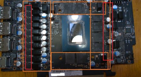

The way I go when apply thermal putty is bellow.
I mirror the orange blocks on the back of the PCB and apply putty on whole orange area(reduce heat by proximity, reduce soaking and long exposure), in that way back plate will suck a lot of heat and your case fans or targeted fans will push it away faster.
The red blocks is a must, are the drv mosfets and will influence the smooth operation of the VRAM but also VRAM temps.
Call me extremist but that is what I do, with most of the cards where heat will kill performance and longevity. Longevity is lottery but, why betting when you can avoid it. For 9070 XT is clearly need it as is a very condensed PCB.
Hope it helps

Adding thinner pads is bad no cooling for VRM and VRAM.
Adding thicker pads is bad too as you can cause damage to the PCB, ripped pads under VRAM and core.
2. EDIT: Manufacturers should save the money they spend on PTM and use it for quality putty.
I asked PNY and they said the paste is high-quality industrial thermal compound applied at the factory to ensure optimal thermal performance and long-lasting reliability.
They will void the warranty if you take the card apart.
But I have seen some reports on other places where the temperature was worse out of the box or paste pumped out in a short time.
You wasted your time asking PNY, didn't expect any other answer from PNY or other manufacturers more than some marketing BS.
Yeah that one cracked/torn pad on the vram out of the box irked me. But I replaced em with good Fujipoly's so it probably won't happen again anytime soon.
Could you list the pad sizes used?
Thank you for the photos, I haven't seen any other teardowns of this card.
I'm surprised that not all 5070 + tier cards are using PTM. Even the Sapphire 9060XT is using PTM7950 (1, 2).
I guess nVidia really is squeezing those margins as tight as possible.
At least the PNY 50-series is using ball-bearing fans. Unlike Gigabyte's entire lineup (1, 2), which uses sleeve bearing fans until the Aorus Master 5090 (which is DBB).
IMO every new card should come with PTM, basic thermal pads (none of this putty like Gigabyte and sometimes Acer (A770, A750)), and DBB or at the minimum FDB fans. If we're going to get price gouged, the cards ought to at least be reliable on paper. QC and random bad luck should be the only two things that kill these multi-Benjamin cards or cause component failure. And I consider TIM to be a component.
On nvidia, only Asus and MSI uses PTM.
PNY uses high-quality industrial paste, Zotac said it's generic paste, Gigabyte has their own paste that they order from the manufacturer, Gainward/Palit has TC-5026 paste.
Gigabyte uses ball bearing only on Aorus(Elite and Master) cards, that was true on 4000 series too, 5070 Ti Master has ball bearings too.
Whatever cheap thermal gel they used wasn't tested enough. Gigglebit and the lot.
IMO a new card shouldn't have PTM because
1.thermal paste can be easy replaceable but, should come with high grade putty for VRM and VRAM, Upsiren 8, HT 10000, TG long lasting cooling performance and no leak of silicon oil as the pads.
Pads is hard to be replaced by users, they don't know the thickness, users have no calipers to measure the thickness.
2. save the money you spend on PTM and use it for quality putty.
At least Palit had an answer, they use TC-5026 paste.
Darn, shouldve brought my calipers. Unfortunately I do not plan another teardown, but IIRC virtually all of it looked like thicker 1.5mm or 2mm pads.
Sorry but when you apply expensive PTM7950, it stays heh.
