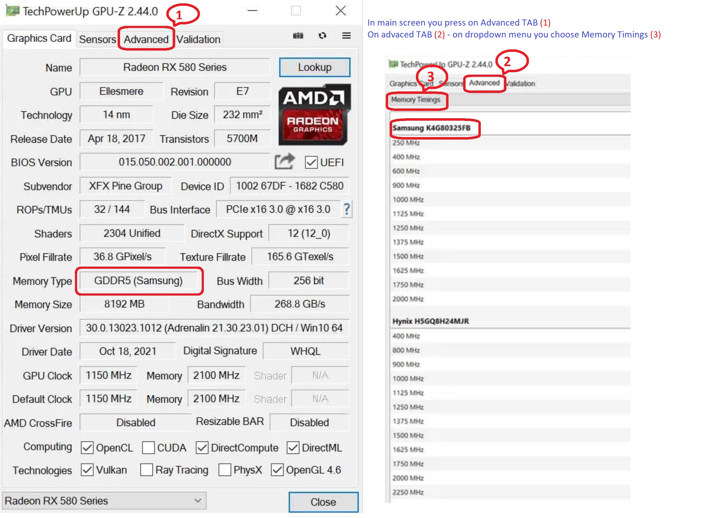

This cards were produced with 3 types of memory.
So in order to narrow the search i need the following picures:
- gpu-z main screen
- gpu-z advanced tab > choose memory info
And yes you will need to do that for each card.
Or if you would like to risk you can use the BIOS i will provide for this for all the rest

To speed the things a bit let me explain:
- if you will see in GPU-z main screen under AMD logo the following : 1002 67DF 1462 8A93 - then you will have the same model as the previous card.
- if you see Micron MT51J256M32HFB - the you have the same memory chips as the original card
You will post pictures here to seaqrch for another BIOS only if you encounter another card with a different ID or same ID but other memory on it.
In rest you will use the same BIOS i provided earlier for all.
