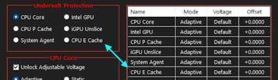

Since I don't want to use Intel XTU and because i can't do it in TS, I use TS only for profiles to control turbo boost, I did undervolting in BIOS by switching the "VF Configuration Scope" setting to "Per-Core" mode, which allowed me to specify offsets for P cores and E cores separately. Because, I have configured everything via BIOS, so I have played it safe and indicated the values for everyday use below. P core -90 and E core -170

I have never had access to a modern Intel CPU with P and E cores while developing ThrottleStop. My 14900HX arrived just after releasing TS 9.7. This will allow me to finally do some hands on testing so I can hopefully improve ThrottleStop further.
I have always assumed that the setting in ThrottleStop that is labelled as E Cache actually controls both the E cache and E core voltage. This voltage is separate from the P core voltage control. I plan to do some XTU vs TS testing in the near future to see if this is true or not.

I compared the values. It's funny that under load on the processor (TS Bench or stress test), the Offset "CPU Core" in TS value constantly changes -0.0996 then -0.1699 and again -0.0996 and so on until the load goes away.
When trying to give -190 to P cores, the laptop simply turns off, which means that Offset CPU Core in TS for some reason reads information in turn during load.

I wrote a small testing tool when Intel first introduced the FIVR in their 4th Gen CPUs. This tool allows me to read and write voltage information directly to the CPU FIVR without needing to run Intel XTU or ThrottleStop. That prevents either program from interfering with the results.
Intel CPUs have two types of registers. Some registers are core based so each individual core or thread of each core can be written to a different value. Most registers tend to be package based. If you write a value to any core or thread within a package based register, this same information will go to every core and every thread of this register within the CPU package. When you read information from a package based register, it does not matter what core the monitoring tool is running on. All cores and threads are set to the exact same value so all cores will return the same data.
For a test I decided to write an offset voltage value to a single P core. This value got written to all of the P cores and it also got written to all of the E cores. When I write 0 to the P core offset register to clear it, all of the offset voltage values in all of the CPU P cores and E cores are cleared at the same time. The exact same thing happens if I write an offset voltage value to only a single E core. This same value is written equally to all P cores and to all of the E cores. This is telling me that the CPU voltage control register is package based. At any moment in time, all of the P cores and all of the E cores are using the same offset voltage information in this single register.
Intel XTU showing that there is a P core voltage register that is completely separate from the E core voltage register does not seem to be true based on the testing I did today.
What is Intel XTU doing? My best guess is that Intel XTU is constantly varying the single core voltage register back and forth between two different voltage values. I do not know how many times per second XTU is doing this. The algorithm that Intel XTU is using to vary the voltage might be based on load or CPU temperature or which way the wind is blowing. The ThrottleStop FIVR monitoring table seems to confirm that this constant voltage switching is happening. If you completely exit Intel XTU, the voltage swapping algorithm should immediately stop.

On my desktop platforms, setting the "CPU E Cache" offset makes no change on core voltage and power consumption, and undervolting it too much triggers an instant blue screen, so I never set it. I only set CPU Core and CPU P Cache offsets with same value.
I also tested on a 13700KF+Z790 platform with 125W power limit and microcode 0x129. Setting negative offset of "CPU E Cache" won't raise E core frequency or benchmark score (CB R23).
This item is related to "E Core L2 Cache" voltage in BIOS (MSI and ASRock). In my opinion, the "E Core (L2) Cache" voltage is just like SA voltage, fully controlled by FIVR, and doesn't affect the global core voltage.
The shifting of offset value is caused by Per-Core offset. I have posted a thread about this. It looks like the value read by TS is a "final value" that CPU picked based on core-parking.
