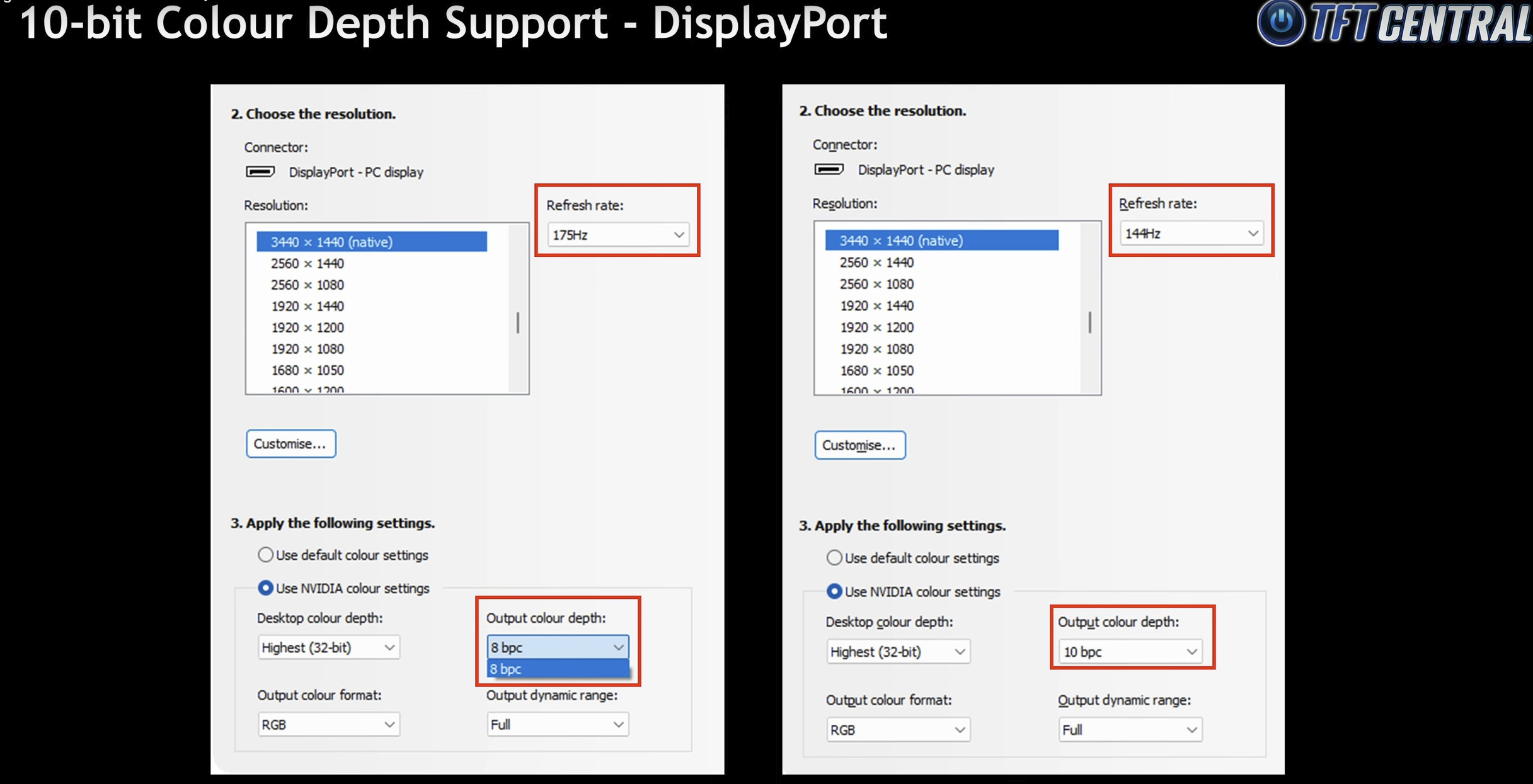

I did and was not sure about somethings but it say in pic nvidia g-sync not certified this mean doesn't support?
and again you talk about dp cable if I use it it work with 8bit only so i must switch to hdmi 2.1 so the question it about it if it really work with that (gsync)
No. It means that NV didn’t test it, which is whatever, really. Watch Tims video FFS.
It will work with DP and 10-bit just fine. It will use DSC. But yes, HDMI will also support VRR.
Mate, just open DisplaySpec, it literally has all the answers to your questions. It’s a 10 second search.
Actually it doesn't use DSC.
So at 175 Hz you're limited to 8 bit only.
For 175 Hz 10-bit you need to use HDMI 2.1 port.
But again, we are doing the research for OP.
That’s… what? I don’t remember when I last saw a modern display that doesn’t use DSC to improve resolution/refresh support. Bizarre. This feels like a firmware bug, to be honest.
My bad then, then he will have to use HDMI. But that supports VRR anyway, so hey.
Edit: Apparently not a bug, they’ve updated the firmware already and no DSC. Confusing, but fair enough. Should be noted that apparently the firmware update improves HDR performance, so I would say it’s a good idea to grab it.

that what i said I need to use hdmi 2.1 for all features that why i ask if hdmi will support gsync you type above dp will support but hdmi too?
