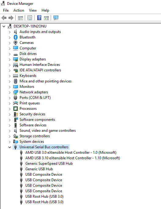

Could be a bad port, could be a driver issue, are there any yellow or red signs in device manager? If so you need a driver, if not you could test a pci usb 3 card, I had one in my old rig because the board plug was unusable with sli cards, cost like $10 on ebay.

I don't see any warning signs. Not sure if I am looking at the right place.

Device manager looks good, so the fault is probably with the cable/case.
