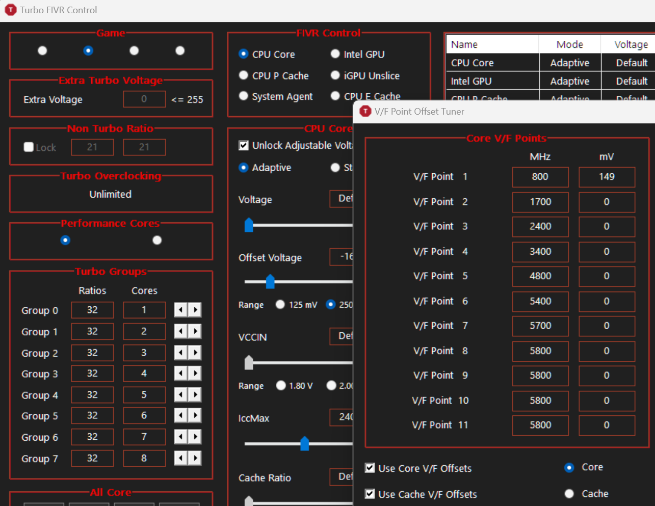

Using V/F point only instead of combining it with offset voltage?
bobert
Mar 31, 2025
5 (0.05/day)
I think most people have been using offset voltage to change the voltage for all frequencies because that's how it's been done for all these years.
But now that V/F point is available, wouldn't it be better to just only use that?
For example, here if I just cap turbo to 34 and then lower and test V/F Point 4, then I don't have to worry about the cpu crashing at lower frequencies because the voltage is too low right?
Has anyone tried just using V/F point and unchecking unlock adjustable voltage?

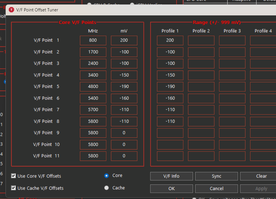

I've also been experimenting with using only the VF points with my 14900HX, using the same method, only I started at the top end and am working my way down in frequency. The main benefit I'm finding is not being locked down to the lower UV allowance in the higher mhz range. Mine can run stable with -190 at 4800 and -160 at 5400, but anything above -110 crashes at higher mhz. If I did just the global offset, I'd have to keep it at -110 (with a small 800mhz boost), which leaves massive room for improvement precisely where it tends to sit during an all-core load.
