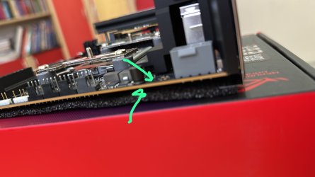

Hello, would small ESD damage motherboard? Just touched there (yellow area) with my hand and mobo was not plugged in. Felt so tiny feeling but I’m not sure.

I doubt not. Hard to say without any testing.
Probably OK, but I am not suggesting not taking ESD precautions.

No. Not really. Static usually fry things right away.........if it didn't happen, then it will not happen later.

Had you said "Could" instead of "Would" and left off the word "easily", I would have said, "Absolutely! ESD can damage a motherboard".
Manufacturers over the years have built in many ESD damage mitigation techniques to greatly reduce the risk. But there is no way those can eliminate possible risks complete.
That said, looking at your picture, it seems you touched the PCB edge and I "suspect" the ESD you sensed was the voltage jumping to the motherboard's ground plane - by far, the safest place to jump too. :) After all, circuit cards should be handled by the edges.
I say, press on and use it. I would bet it will work fine. But from now on, especially when handling sensitive devices like the CPU, RAM modules and cards, try to remember to touch a grounding point (bare metal of case interiors are good) before reaching for the sensitive device.

It is critical to understand that a static discharge can be so tiny, it is below the "threshold of human awareness", yet still be "destructive" to sensitive devices. That is, we (mere humans) may not see, feel, or hear that a "destructive" discharge even occurred! Yet it can still easily have enough potential (1000s of volts!) to torch a Grand Canyon size (microscopically speaking), scorched trench through 100s of 1000s, even millions of transistor gates of ESD sensitive devices. And not such destruction is only visible through powerful microscopes.
So if you felt it, it was big. But again, going by your image in your opening post, it appears as though the arc from your fingers went to the boards ground and thus unable to cause any damage to sensitive devices.
Now, if, for example, you had loose RAM sticks or a CPU on your desk and you reached for the device and the arc jumped to one of the RAM's contacts, or the CPU's pins/pads, then I would be concerned. But with your issue, I am not.
