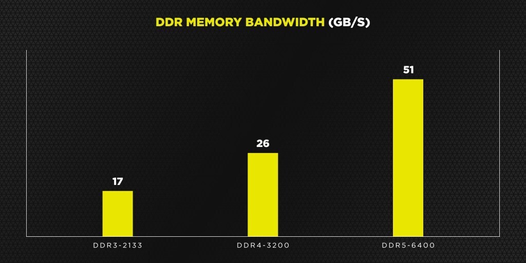

The fifth iteration of DDR technology, called DDR5, is set to arrive later this year. Many makers of DDR4 technology are announcing their plans to switch to the new standard, and CORSAIR is no exception. Known as the maker of high-quality products, CORSAIR has today posted a blog post teasing company's upcoming DDR5 products, and what they will be bringing to the table. For starters, the company has posted data about DDR5 modules that run at 6400 MHz speed, which is assumed to be the speed of the CORSAIR DDR5 modules when they arrive. At such speed, the memory can achieve a bandwidth of 51 GB/s, which is almost double the 26 GB/s that DDR4-3200 MHz memory achieves.

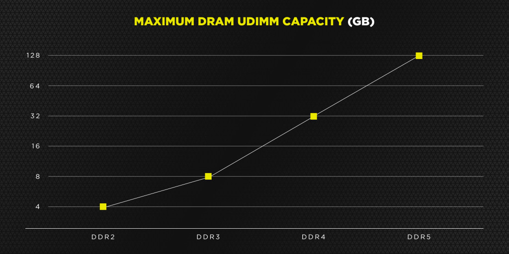

Another point CORSAIR wrote about is the capacity of a single DIMM. With DDR4, the company has made DIMMs that are only up to 32 GB in capacity. However, with DDR5, CORSAIR plans to quadruple that and build a single DDR5 DIMM that has up to 128 GB of memory on it. Another big point was the power required to run the new technology. The DDR4 standard required 1.2 Volts for operation, while the JEDEC specification says that DDR5 needs just 1.1 Volts to run. This will result in a cooler operation of memory modules.

51 GB/s is not very impressive. Especially at CL46 best case. My DDR4 at 3733 can already do over 50GB/s at CL14.
My guess is that first gen DDR5 will not be very impressive. And due to the voltage regulation and ECC being onboard i expect DDR5 to be the most expensive main memory standard yet.
It wont be until DDR5-8000 speeds that it starts to overtake DDR4 in terms of performance and equals DDR4-3200 CL16 latency. But 8000+ speeds wont come until 2022 at the earliest. 2023 most likely.

51GB/sec for DDR5-6400 is with 64-bit bus (single channel). Your 3733 has max rated ~59GB/sec of bandwidth on "dual channel mode", 64-bit (single channel) DDR4-3733 is less than ~30GB/sec. APU's will get the most benefit, latency and timings will improve with time as with all new RAM technology that starts slow and them ramps up.
Wait a second. If all DDR5 sticks are essentially dual channel on a stick then how can someone get 51GB/s by running a single channel?
And if that's the case why would Corsair of all companies say the 51GB/s number in their press release? Would they not advertise the bigger 102GB/s number instead?
Makes no sense for manufacturers to quote only single channel numbers at this stage.

Because they are getting 51GB/s from a single stick running two 32 bit channels instead of a single 64 bit channel. All this single Vs dual is confusing people.
DDR5 uses 4x32 bit channels instead of 2x64 bit channels. Two sticks still give you a 128 bit data bus. The 51GB/s is not from each stick beign dual channel and is rather from the 6400 mhz clock speed.
Manufacturers have been quoting single stick memory speeds since forever. It's still a valid comparison, just multiply the number by 2 for your dual stick config. The DDR4 number quoted is also a single stick speed.
Makes no sense for manufacturers to quote the lower number. They always go for the highest even if it may not be completely truthful or realistic. The same way SSD manufacturers advertise peaks sequential at qd64 or higher instead of random 4k at qd1. Besides what you say conflicts with what 50eurouser said about single channel DDR4 being less than 30GB/s. I very much doubt that manufacturers who thus far have advertised DDR4 dual channel speeds now suddnly only quote DDR5 single channel speeds. I think hoping for those numbers to be single channel only is wishful thinking.

Can you link one of these speeds claim on DDR4 that aren't on a dual channel modules ?
You're comparing two sticks of DDR4 with one stick of DDR5.
DDR4 at 3733 has a channel-bandwidth of 29 GB/s, and that includes CAS / RAS messages (which are important to make the RAM work, but do NOT contribute to application-level bandwidth). Two sticks of DDR4 going 29GB/s will be a little bit over 50GB/s in practice.
The 51GB/s quoted here is a single-stick DDR5 channel bandwidth

can these RAM manufacturers stop making DDR4/ and next gen DDR5 Modules with ridiculously High/ Very Tall Heat spreaders, My ddr4 4000 ram never even get warm @ a 4266 CL 20 OVERCLOCK tight timings? so HEY DDRxxxx manufacturers, STOP WITHTE REDICULOUS TALL HEAT SPREADERS DAM*IT
If people only jerk off on the CL timming, indeed... But there is far more than that.
exactly , i get the ram with high MHz low "CL" OR Cas-Latency, but then tighten up all the other sub timings, and poof, better performance (sometimes)
Dec 28, 2012
3,530 (0.85/day)
System Name Skunkworks
Processor 5800x3d
Motherboard x570 unify
Cooling Noctua NH-U12A
Memory 32GB 3600 mhz
Display(s) Asus 1440p144 27"
Mouse *squeak*
Software openSUSE tumbleweed/Mint 21.2
Well feel free to tell the industry they've been doing it wrong since, what, 1982?
They ARE quoting the highest number. Compared to last gen their DDR5 number is a major improvement. Running multiple sticks as a single memory channel is not a feature of memory. That would be like if a motherboard manufacturer talked about how great their OC capabilities are thanks to a certian cooler, thats got nothing to do with your motherboard. Memory makers will always quote the bandwidth of a single DIMM when discussing a new generation of memory, because quoting dual channel numbers wouldnt be accurate if the end user had, say, a HDET platform with quad channel memory.
You know DRAM calculators are available online, right? DDR4 is less then 30GB/s per DIMM. This is not new information. For instance, we can look at the company Transcend:
They list their DDR4 memory bandwidth per dimm, just like the corsair press release. And:
DDR4 data transfer rates:
DDR4 2133:17 GB/s
DDR4 2400:19.2 GB/s
DDR4 2666:21.3 GB/s
DDR4 3200:25.6 GB/s
So take that 3200mhz memory speed, double it to 6400, which this DDR5 claims to run at, and you get 51.2GB/s, the claimed speed form corsair.
